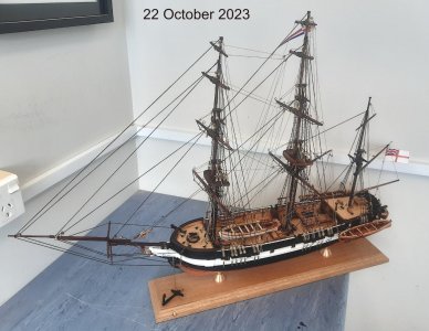

I've added a picture of my Beagle (I'm building ships of exploration) which I did some time ago. The rigging was completed by a model maker (Terry Dale) at the Auckland Museum of the Sea as I ran out of time before heading overseas. (Unfortunately my son was transporting it in the back of his truck when his friend got in and threw her luggage in over the back seat without looking - I've yet to see the damage !
Great job on that Beagle Harry but horrifying to know the model is probably damaged. Your photo shows you have skills so hopefully you can reconstruct her.
