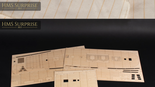

I would suggest to wait for chris watton, in February or march also with a big "surprise"7/10 from me. I would have given it a 9/10 if it weren't for that artificially cheap burnt deck, bleeh, it simply needs to be replaced during construction. Thanks for keeping it to scale; i knew it was her, French corvette![]()

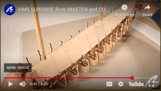

The origins are a work of FICTION by Patrick O'Brian. Does this source define the number of stern lanterns, ordnance and deadeyes?The video refers to the ship in the movie Master and Commander. Is this model supposed to be fictional ship from the movie that used the modern replica ship Surprise 1970, the real ship 1757 Rose on which the replica was based, albeit with some changes, or the real ship HMS Surprise 1796? There are some oddities that make it difficult to tell what ship this is supposed to be.
If it based on the Surprise 1796, she had 8 stern lights, but the video shows only seven. I doubt the British tore out the original framing when they captured Unite and redid it to accommodate seven instead of eight lights.
The RN did not allow names of ships on the stern except between about 1771 and 1780 in the days of sail.
If it is based on HMS Rose there was only a single wheel, not a double wheel. The double wheel in the kit seems to be near the fore end of the QD rather than aft of the mizzen mast. The tiller would have to be much too long.
The model shows 13 gun ports compared to 14 on the contemporary drawings of HMS Surprise 1796 or 12 on the HMS Rose.
Looking at the figures, they could not get their hands and fingers around the giant belaying pins or the wheel handles a mistake seen on all AL kits.
The bottom stops in the gun ports are missing.
The number of deadeyes does not match either the Rose or Surprise 1796
There may be more, but these were easy to spot.

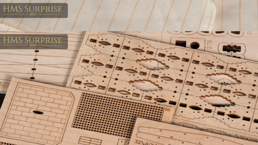

Hmouai, must be fun to clean charred wood cuts... These kinds of kits are for all those who like assembling giant jigsaw puzzles with all the pieces nicely arranged and numbered, helped along with most elaborate and unmistakable instructions. But if it makes one happy to be taken for a fool, then just go for it. I rather stick with my, sometimes very old, imprecise, 'passé' vintage Steingraeber sets. At least, that way I can build something of my very own, just shy of a right out scratch build. OK, it doesn't always turn out as I hoped it would, but then ...Why companies moving in this direction???

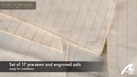

Seriously, introducing cheap laser cutting into the model is a complete failure. I thought only deck boards and decorative elements were burned, but gratings, sails??? Yeah sails... Come on, let's be honest... deep FFFFUUUCCCC...
First boarding Santa Ana, still 10/10.
View attachment 548246View attachment 548247View attachment 548248
Deck elements, gratings, and jointed decorations are impossible to clean. In 1/48 scale, this would permanently damage the wood. From a distance, it's not a problem, but up close, it's incredibly painful. I understand doing this in larger scales like 1/72 or 1/84, as the burn marks are small, but in 1/48 scale???Hmouai, must be fun to clean charred wood cuts... These kinds of kits are for all those who like assembling giant jigsaw puzzles with all the pieces nicely arranged and numbered, helped along with most elaborate and unmistakable instructions. But if it makes one happy to be taken for a fool, then just go for it. I rather stick with my, sometimes very old, imprecise, 'passé' vintage Steingraeber sets. At least, that way I can almost build something of my very own, just shy of a right out scratch build.
