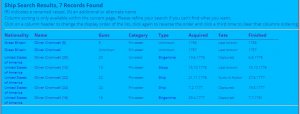

If we take a look at "threedecks" we can find 5 US-ships with the name Oliver Cromwell at this time
https://threedecks.org/index.php?display_type=ships_search
Here are the links to the different ships mentioned in Threedecks:
20-guns https://threedecks.org/index.php?display_type=show_ship&id=13315 -> not mentioned in first post (web-page American War of Independence at Sea)
this will be our new number 5)
10-guns https://threedecks.org/index.php?display_type=show_ship&id=19092 -> number 2) in first post Massachusetts Sloop
22-guns https://threedecks.org/index.php?display_type=show_ship&id=19094 -> number 4) in first post Rhode Island Ship
24-guns https://threedecks.org/index.php?display_type=show_ship&id=19093 -> number 3) in first post Pennsylvania Ship
16-guns https://threedecks.org/index.php?display_type=show_ship&id=19091 -> number 1) in first post Massachusetts Brig/Ship

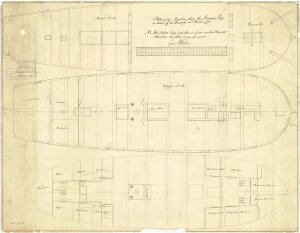

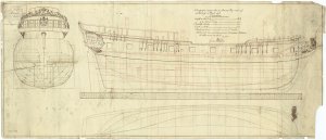

And these are the two drawings available at the NMM of the HMS Beaver´s Prize
Beaver's Prize (captured 1777)
American privateer captured by HMS Beaver on 19 May 1777. The proposal to name her 'Convert' was cancelled.
Read more at http://collections.rmg.co.uk/collec...essel;vesselFacetLetter=B#GUY3EbCmKXVBszcC.99
Scale: 1:48. Plan showing the body plan, stern board outline with some decoration detail, sheer lines with inboard detail and figurehead, and longitudinal half-breadth for Beaver's Prize (captured 1777), a 14-gun Ship Sloop. The plan illustrates her as taken off at Sheerness in March 1778, and the proposed alterations. Signed by George White [Master Shipwright, Sheer ness Dockyard, 1773-1778]
Read more at http://collections.rmg.co.uk/collections/objects/84087.html#Q7AOpiiHKMUS5hMI.99
Date made: Post March 1778
Scale: 1:48. Plan showing the quarterdeck, forecastle, upper deck, and lower deck for Beaver's Prize (captured 1777), a 14-gun Ship Sloop. The plan illustrates her as taken off at Sheerness in March 1778, and the proposed alterations. Signed by George White [Master Shipwright, Sheerness Dockyard, 1773-1778]
Read more at http://collections.rmg.co.uk/collections/objects/84088.html#9FCmk6wKuRQgEx28.99
Date made: Pre 28 March 1778

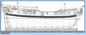

The two drawings shown on the web-page of awiatsea named "Reconstruction of the lines of the Oliver Cromwell. From Millar, American Ships of the Colonial & Revolutionary Periods, 207" were 100% taken over of the NMM contemporary drawings!

but at threedecks this information for a ship which could be the only one ex-Oliver Cromwell:
https://threedecks.org/index.php?display_type=show_ship&id=20411
