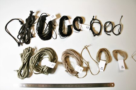

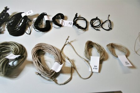

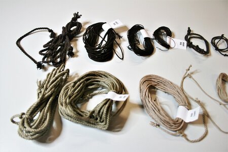

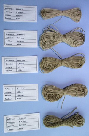

I make my own strings using a homemade stringing machine. I can sell cotton, polyester or polyamide ropes at very attractive prices. I have 3 strand or 4 strand ropes with core in different colors. But so far I have only delivered in France. I'm not sure how to easily send ropes outside the European Union.
Here are some examples (polyester) :
Contact me if you are interested.
Kind regards,
Fred
Hello,

Hallo Fred,
Your ropes are looking very good
You can also start a new topic especially for your offered ropes, maybe here!?! With this your offered ropes can be find easier in future
only a small hint:
I guess the diameter of one ropes (red arrow) are incorrect, due to the fact that the photo is showing a thicker rope than the 1,2mm example - please check (in moment you have two times 1,2mm mentioned
