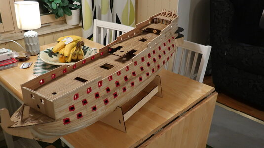

Pågående Projekt: ZHL San Felipe
I am working on the ZHL San Felipe.
Can someone guide me to where I can find better plans, since the accompanying plans are not very good.
Will appreciate the help.
Jag jobbar på ZHL San Felipe.
Kan någon guida mig till var jag kan hitta bättre planer, eftersom de medföljande planerna inte är särskilt bra.
Kommer att uppskatta hjälpen.
Hej. Jag har väl samma byggplaner som du antar jag. Hur långt i bygget har du kommit och vad är huvudproblemet just nu.

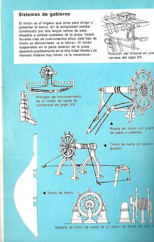

Have you ever had a look on Google: try Galleon San Felipe? there is a lot of info.
about the stirring wheel, there as far as I know no stirring wheel as such. halt below the deck there was a sailor, who sirred with a wooden shaft- starboard to one side and backboard to the other. I have an image somewhere, but will have to find it.
try to have a look at other Spanish ships about the time

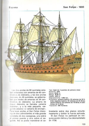

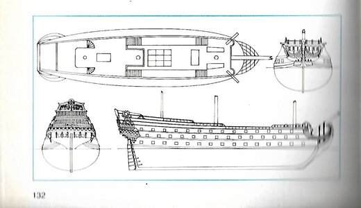

I finally found the book with the needed info on the stirring method and a museum drawing and a painting of San Felipe.
I will first have to enlarge the info. in the book and then scan it.

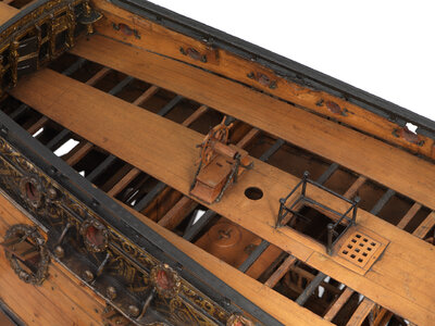

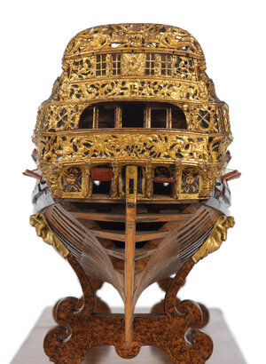

Interesting also this contemporary model
Warship (1703); Fourth rate; 50 guns
Scale: 1:48. A contemporary full hull model of a 50-gun small two-decker (circa 1703) built plank on frame in the Navy Board style.
This model is unique as it is fitted with both a steering wheel and the remains of a whipstaff. If the wheel is original, it is the earliest evidence known for this fitting on an English ship.
View attachment 388142 View attachment 388141
