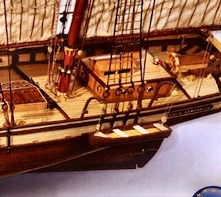

Based on the picture, it looks like you have done a nice job. The small boat seems to match the ship pretty well. However, you may want to consider painting the boat gunnels a color that can be easily seen from a distance and distinguish it from other small boats in the water.
If you agree that the time and effort you put into detailing the ship should be reflected in the small boats attached to it, the book: Planking Techniques for Model Ship Builders by Donald Dressel has a chapter explaining how to scratch-build a small boat, but there are many good books available.
I hope that I was able to help, Terry

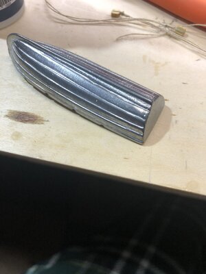

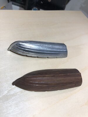

Thanks all for the kind comments and advice. I did use a razor saw etching marks horizontally. I think the paint filled most of that in.
I did think about scratch built but I just don’t have the skill set to do that. I looked at lifeboat kits too but their size didn’t work
And yes I’d like to paint the gunnels and keel a darker color. I don’t have a steady enough hand to do by eye. I’m afraid if I tape it it may take some paint off when removing the tape. I might try this on the stern (easier to repair) to see if it works.
Again thanks

A light contrasting color... e.g. white, yellow, red, blue just along the top of the gunnel could be easily seen against the dark sea, just saying?
Terry

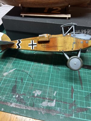

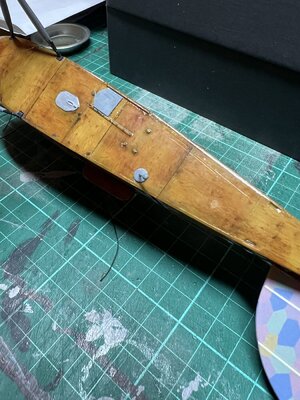

I tried this: primer, medium brown spray paint, darker brown acrylic (with a saw tooth cut stiff brush, blotted with a damp rag and acrylic black thinned with water and blotted that.
Not perfect but may work. Any thoughts???
Looks very good. Tearing off a piece of washing-up sponge would work as well. There are a lot of wood-simulating techniques on YouTube. But you need to look for plastic models - some of those guys are magicians
Stay happy , keep modeling

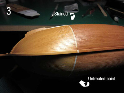

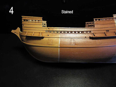

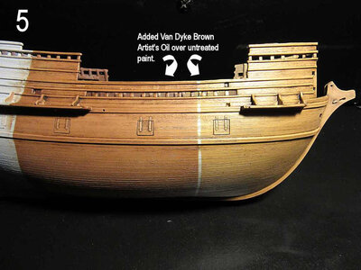

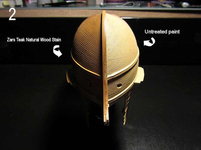

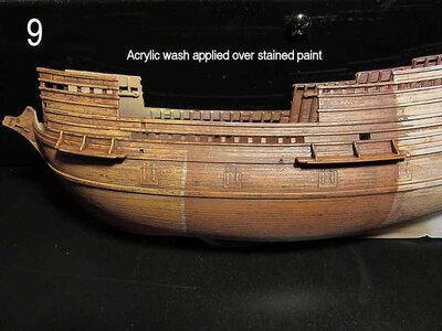

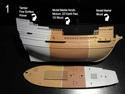

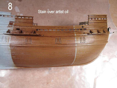

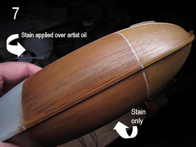

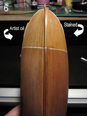

Try the method illustrated below. I wish I could credit the original author but I don't know who (s)he is; the pictures were sent to me years ago by a buddy overseas who no longer recalls the source. For the moment, suffice to say I have had excellent results on a variety of poly-based surfaces as well as on various metals and gloss-glazed ceramics. The key is to make certain the surface is well cleaned before priming.
