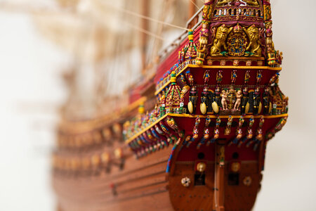

For example...there is this...

@dockattner - and BTW, you're REALLY bad for morale using that as an example! lol. How the heck you get that detailed???
...this is why I tagged Paul, I know and really impressed for a while with his skills and the work he does. BTW, WASA is the first model he built!!!! Yea... how about that!
I could teach you to do that :). But I suspect you're aiming at something less... well, less...ROTF.

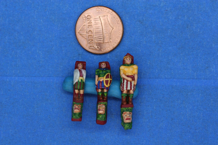

He layers different shades of each color to add detail and depth. Look at the shades of white, green and yellow on the figures below. The effect is not something you can get on such tiny figures using a single color or a dark wash. A dark wash of brown would dull the overall brightness of each figure. Painting lighter shades on the highlights maintains the overall brightness of the figures. Dark highlights were used on the faces below the figures to enhance the cheeks and jawlines a bit. The effect is wonderful. But, it takes TIME.

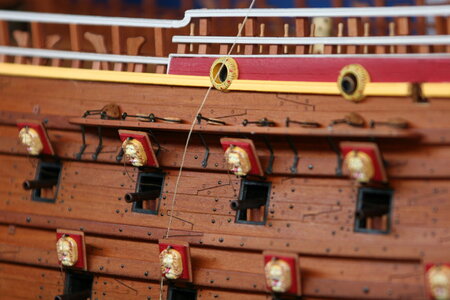

PS: Here's a particularly nice painted hull (begins here and continues):
There are others but this one popped into my head.
