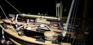

Hi,
I recently finished the Panart Armed Pinnace in 1:16 scale (see completed builds). I was so impressed with the ingenuity involved in mounting a land cannon in a long boat that I have decided to build a copy of the system in 1:8 scale as a display. The gun system in the original kit is about 21cm long so by doubling all the dimensions I will have a display that is 42cm (apr 17") long.
This is a photo of the original gun system from the 1:16 kit.

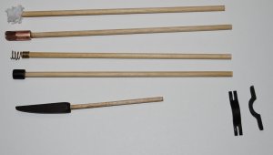

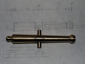

I got my first look at the cannon. It still needs a bit of refining, we came up with 3/8" for the bore and 1/2" for the trunnion.
I built a set of tools following the original instruction however made them to fit the revised bore. The powder measure is made from 3/8" copper fuel line.
There is no way (I can think of) for me to make the two capsquares from metal so they are simply drilled and shaped wood. Any ideas for future work would be appreciated.

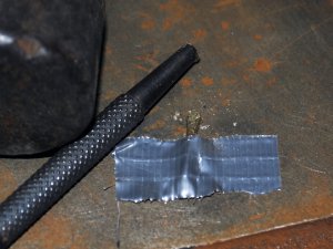

The 4 pins are brass, flattened with a punch, and drilled to take the chain.

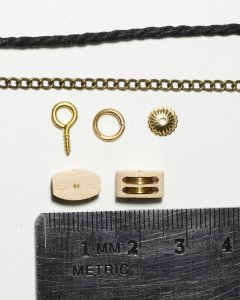

As I mentioned, the main rope is 3 strands of #20 hemp. The pulleys came via the internet. The other small parts are; 3/16 screw eyes and rings, the chain and small decals are from a dollar store necklace.

And, I now have the finished cannon. 20cm (8") long.

Hallo, it is looking good, realy good. Did you produce the muzzle by yourself, on a turning lathe? It is looking realy good!

Thank you Uwe, the muzzle was made by a friend with a lathe. I will re-think the screw eyes, even with the ring attached the join is visable.

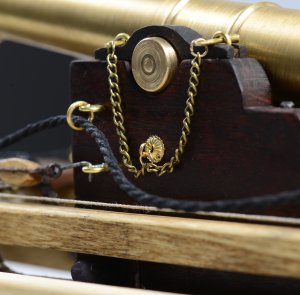

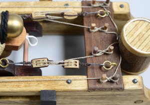

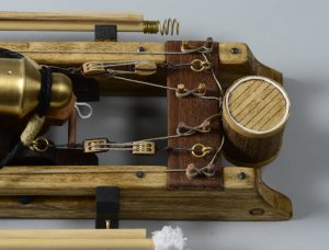

Hi there, all done. I did solder the screw eyes where the joint is visible and made 10 square head "bolts".
As per the build by member Graham I put the loading and cleaning tools along the side of the track.
Here are some pictures, I think it came out well. Cheers.

You made a small piece of art..... it is looking great..... well done.
