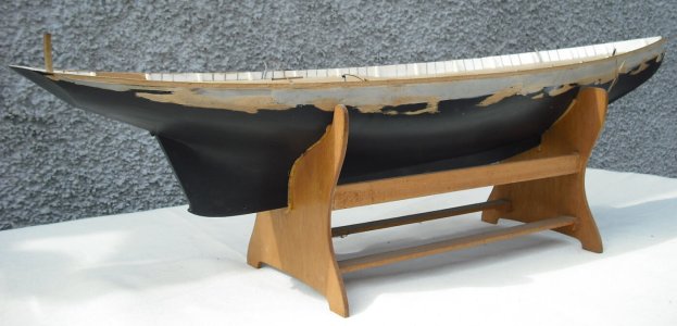

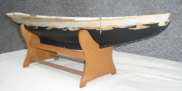

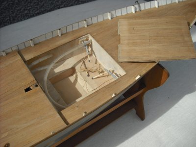

Grand Banks Schooner Elsie
This is built as plank on bulkhead using Model Shipways drawings. Keel and bulkheads are plywood, hull planking is lime strips, and deck planking is lime strips laid on plywood sub-decks. This was intended to be a radio controlled working model so is fitted with ducts for the running rigging, with the sail winch planned to be under the foredeck and radio under the deck cabin. The hull was reinforced internally with fibreglass mat and resin for watertightness and strength.
The bare areas in way of the bulwarks are correction of a mistake, as I misread the drawings and did not notice that the bulwarks were thinner than the hull planking. I found this mistake when I bought a copy of Howard Chapelle’s “American Fishing Schooners” and found a complete set of Model Shipways drawings and instruction book for the “Benjamin W Latham” schooner in a maritime bookshop.
This is the state of completion as of end 1978. Progress halted after I moved north, bought a house, got married and started working abroad.

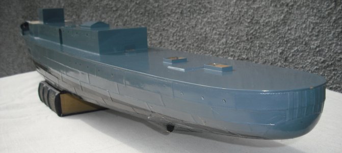

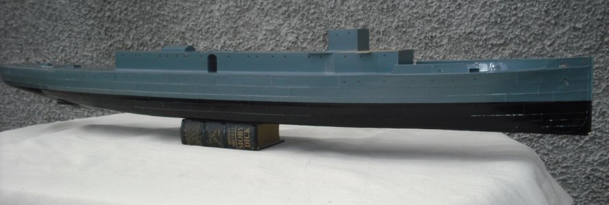

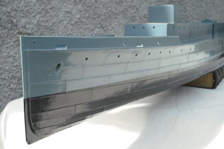

Hunt Class Minesweeper HMS Northolt (1918)
This is a static model and is built as bread and butter construction using the shipbuilder’s as-fitted arrangement plans bought from the National Maritime Museum, London. These comprise profile, deck plans and a range of sections which provide enough information to develop templates to shape the hull. There was also a model of one of the class in the Imperial War Museum, London from which I was able to make notes. I also bought a photo of the actual vessel from the maritime museum.
The hull is plated with thin file divider card. Each plate is embossed from behind to simulate rivets, using the pointy end of a blunt marlin spike, rivet by rivet (very tedious). Looking at this fresh, and with 50 year’s hindsight, I don’t think the riveting is correct. The heads scale up to 2”-3” diameter which is probably too large. Plus the rivets project out too far and are flat topped rather than domed. Also I think the vertical lapped seams for each strake should have double rows of rivets.
This is also the state of completion as of end 1978, for the same reasons as noted above. Unfortunately the model suffered some damage during a later house move, principally to the starboard forward bulwark, bridge wing, and general dents & paint chips.

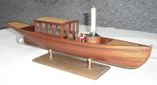

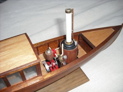

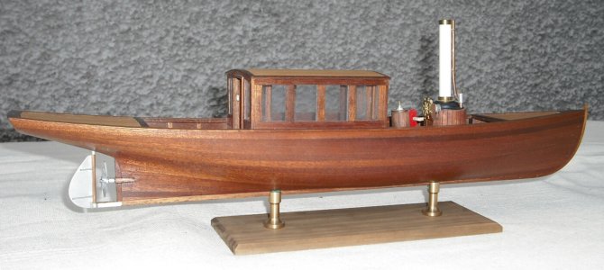

Steam Yacht
This is a static model built from a French kit, bought while I was working in Paris in 1990 and wanting something small enough to put in a shipping tube for when I moved around. Only the hull and decks are from the kit. The cabin was scratch built as inspired by the yachts in the Lake Windermere Steamboat Museum, and the steam engine was scratch built using plasticard, wood, brass and aluminium, based on photos and drawings found on-line.
This model was progressed in various countries as I moved around, reaching this stage in 2002.
