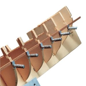

agreed. i have a set and they work very well. A little pricey to get them to Canada, but such is life...
Have you had luck using them multiple times without breakage? I remember having these in the past but most of them broke. I learned soon thereafter that clamps are not needed for planking most of the time anyway. Spiled or otherwise pre-shaped planks go on with finger pressure for a few seconds with CA or maybe 45 seconds using carpenters glue. It appears that some of the kit makers are now supplying laser cut spiled planks which makes things a lot easier than in the past and no clamps needed.Planking screws from Micro mark, are your friend.
