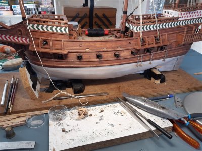

Pelican scale 1/45 a small English galleon 16th century

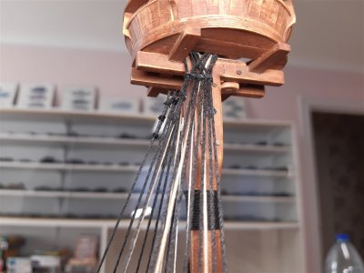

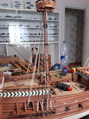

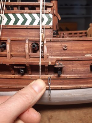

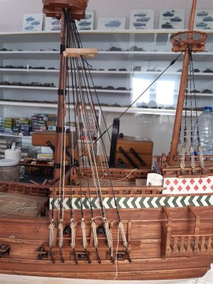

Attaching the shrouds to the mainmast.

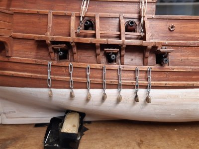

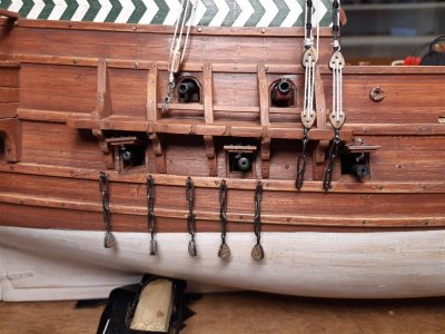

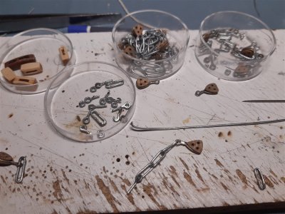

Making fittings for the deadeyes from metal wire and soldered. Each chain has a different total length. This is achieved by making one of the chain links longer or shorter.

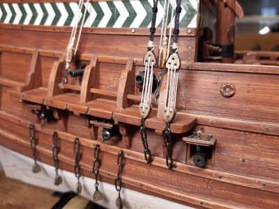

The grooves in the channel had to be adjusted for a proper fit.
The chain / deadeye is not attached to the channel.
metal unpainted
Metal painted (Mat black and pencil)

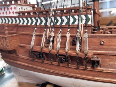

and rigging started
The shrouds are attached two by two, starboard, port, starboard....
All are attached.

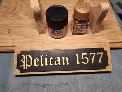

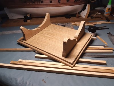

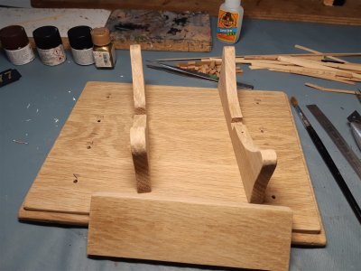

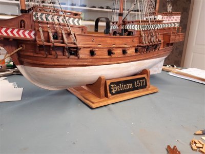

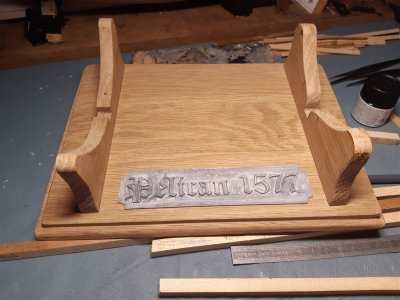

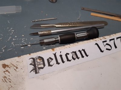

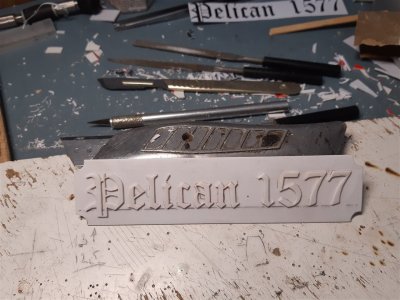

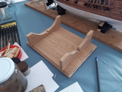

The stand and the ship's name.
This is made from scrap of oak.

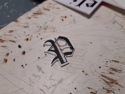

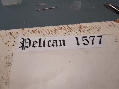

The name was first printed in Word. And the printed paper was glued onto a sheet of polystyrene.
The letters were cut out, glued in place, and painted.
