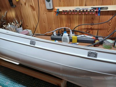

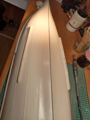

First I removed the bumps on the hull, then drilled out the scuppers and hawser holes and filed them open. Next comes the stand.

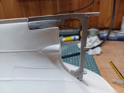

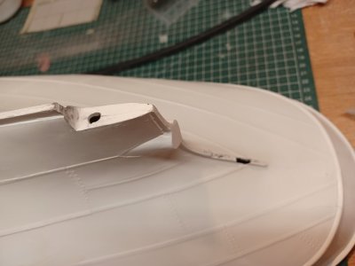

Hello

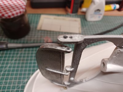

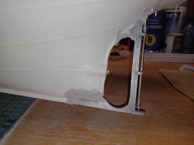

So we continue with the rudder bracket or rudder stand.
For this I had to drill more holes in the hull and I didn't feel comfortable doing it but what must be done must be done. Then I adjusted the rudder bracket.
I will glue it in like this later, the gaps will no longer be visible afterwards.

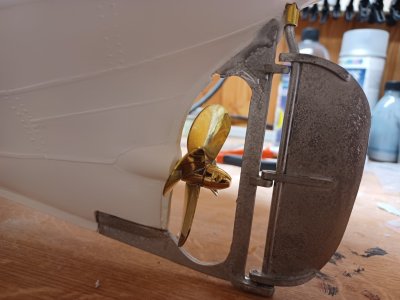

Hello

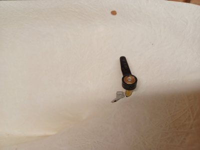

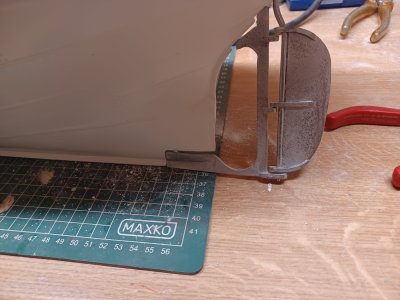

I had a slight problem with the rudder.
When I glued the rudder mount, epoxy resin ran down the rudder, right down to the pin.
Bang. Bombproof.

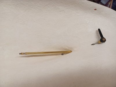

When I removed it, the nipple on the rudder broke off.
After the initial shock and a lot of thinking, I drilled out the piece and also drilled a 2 mm hole in the rudder.
Now I'm going to get a 2 mm winning rod and then we'll see.

Hello, hello
I repaired the rudder by gluing in a piece of metal wire. So far it's working.

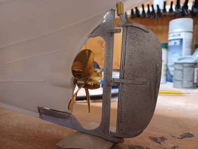

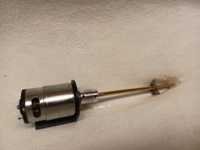

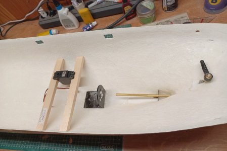

Then I glued in the stern tube with epoxy resin, that's also in place.
Next I'll glue in the motor mount. More on that later.
It's only going sooooooo slowly.

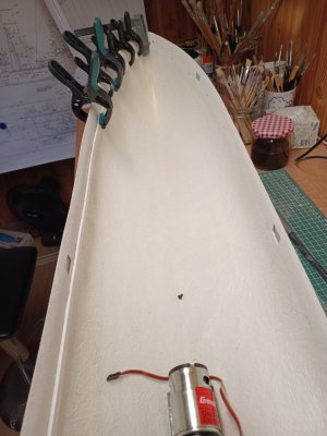

I've finished the stern with the rudder and put filler on the rudder mount on the hull. That has to dry now, then I'll sand it again. I've also glued the motor mount in place with epoxy resin.

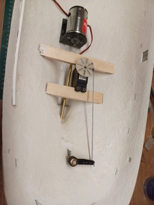

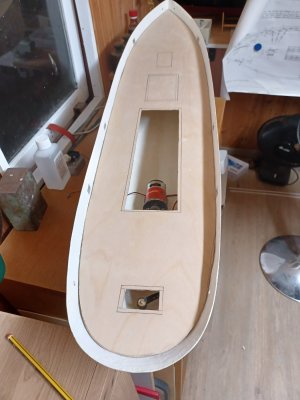

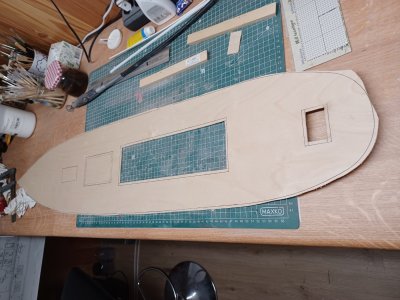

I got my new servo today. I wasn't happy with what I had. The impact angle wasn't big enough, but more on that later.
Then I roughly shaped the first deck.
