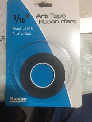

You might look at ‘Art Tape’ too. Available in 1/16, 1/8 and 1/4” sizes. Adhesive backed; I’ve only used black but think it comes in white as well. The surface is matte black and imitates iron well. I’ve shellacked over it or put a dab of matte acrylic varnish on the end to make sure it doesn’t let go. At some art supply stores.

Many thanks for the tip. Can you say what the material of the tape is?
