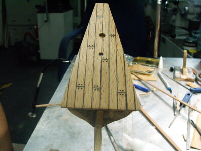

Just for an idea

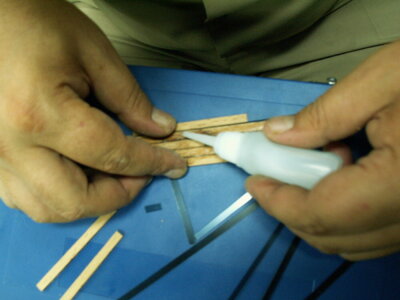

I always use x-ray films.
Fist I cut the x-ray film into strips.
And then glue to the wood with Cyanoacrylate adhesive then sand it.

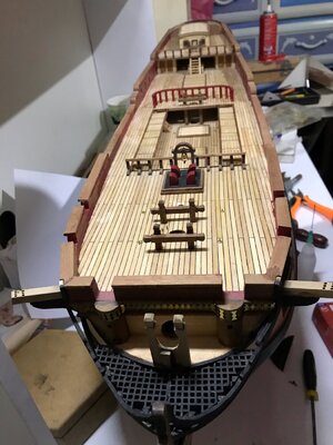

And the result
I used same technique on my latest project Montanes. Process was very very frustrating and slow for the size of the model . But the result is super. :)

I was thinking about the use of strips of black (120gr) paper by the building of the Bluenose. When you lay down a new plank, you can fit the paper strip between . And it is easy to sand, together with the surface of the panks.
