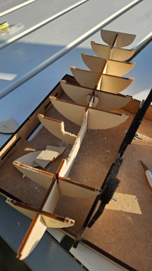

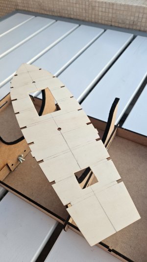

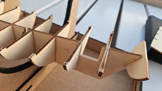

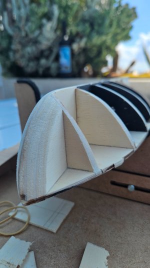

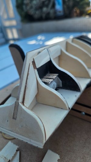

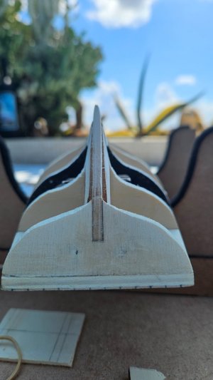

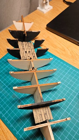

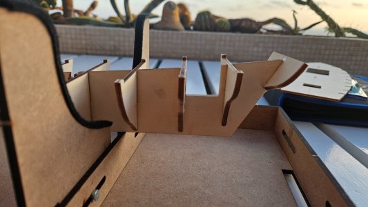

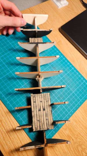

First, I glued the frames in place. Then I used a craft knife + saw blade to cut out parts of the frames to make room for the lower deck:
At the stern it was easy - I only had to cut out a small piece. At the bow it was a bit of a challenge - I couldn't do it using the craft knife. So, I decided to use a drill with 1.5mm bit:

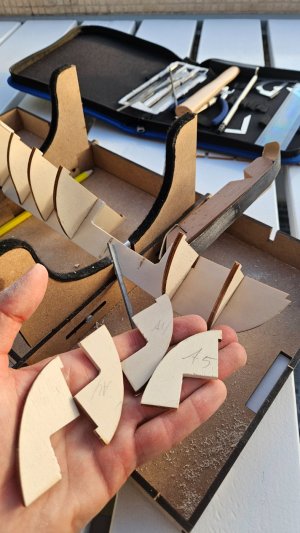

Unfortunately, I broke frames A4 & A5 ROTF:
I didn't give up and glued them with CA glue. I sanded down all the areas, and they look as good as new.

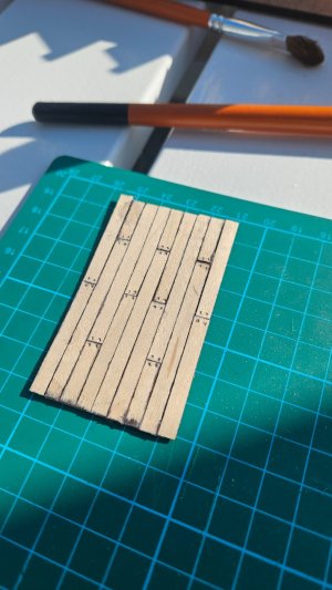

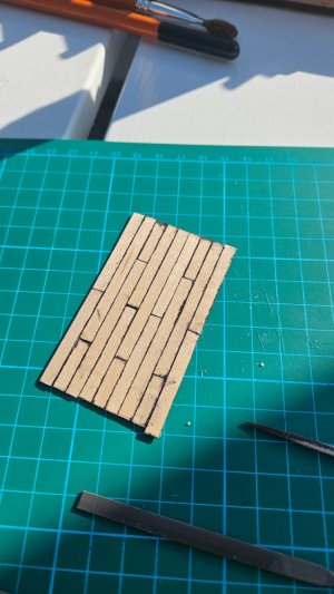

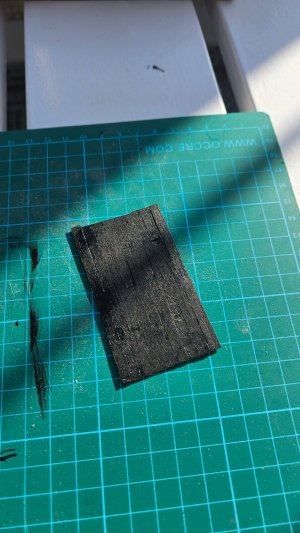

For the deck I cut 6 cm planks. I used an action knife and realized it would be a great idea to order an Amati strip cutter :D
I marked the edge of each plank with a black marker:

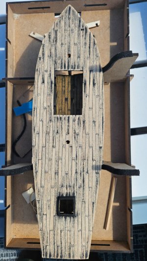

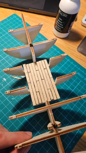

Then I made the lower deck:
The whole deck-making process:
1. Glue the planks and sand them (120–150 grit)
2. Make treenail holes (I used a bit from Ikea toolset and a hammer);
3. Paint black (because it's going to be a pirate ship!);
4. Sand it (120-150);
5. Stain it (walnut stain);

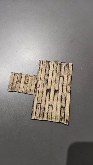

20260916_164037.jpg20260916_164743.jpg20260916_170413.jpg20260916_221011.jpg20260916_224602.jpg

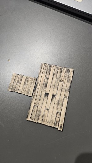

The result:
When I put the lower deck in the bow I realized it was silly to make it rectangular - but I'm going to put some cargo there - barrels and crates - so no one will notice this flaw :)

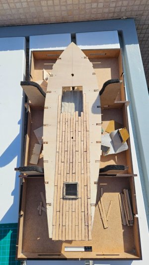

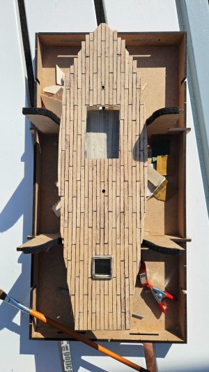

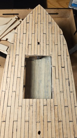

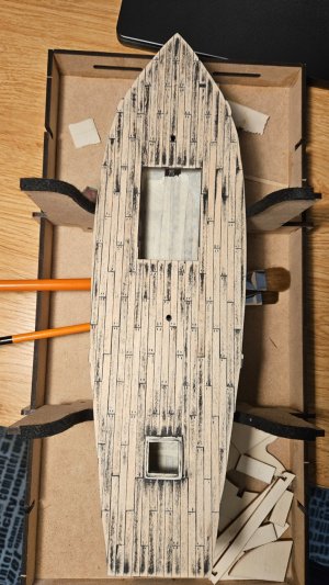

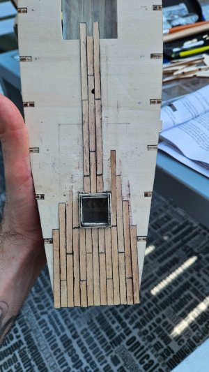

Then I glued the deck and started planking it. A few times I had to remove already glued planks - symmetry was off:

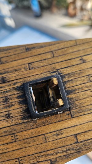

Also it was silly not to cut planks beforehand and it was tricky to make a neat rectangular hole at the bow. I used a file very careful. And the result looks nice:

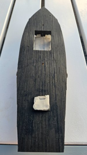

Then I sanded it, made treenail holes, painted black and sanded it again:
I really like the result!

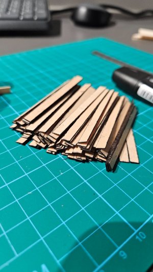

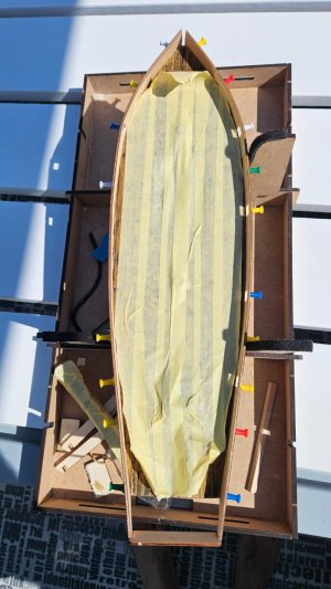

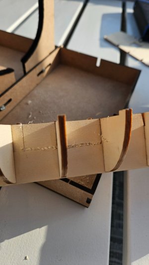

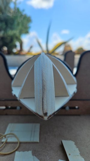

I sanded the hull. What I don't understand is whether or not that is enough. The planks fit well when I lean them...

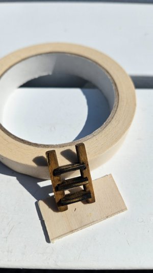

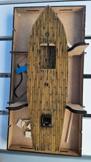

I spent a lot of time to create a little stair. I don't like it 100% but it's good enough :)
The deck is painted and the next step - place the bulwark! :eek:
Question-MarkI see the dust is stuck to the painted surfaces. How do I clean it? I tried using a sponge, but it didn't work.

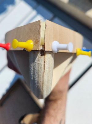

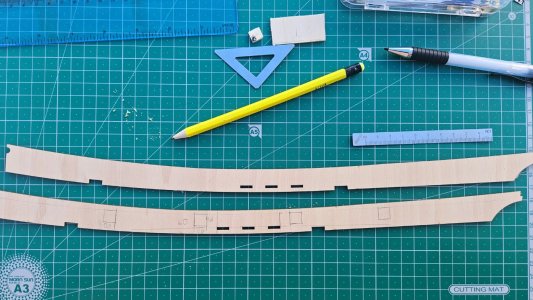

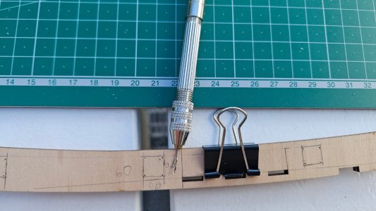

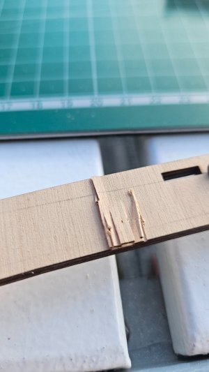

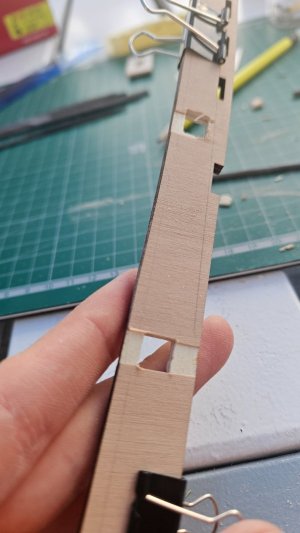

I cut the gun ports in the bulwarks - there will be 8x cannons. Unfortunately, I damaged the bulwarks a little, but the planking will cover it:
Before gluing, I inserted pins and sanded the bow a little. There's a gap at the bow - I can't join the two bulwarks. I hope to fix it somehow later.
