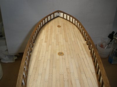

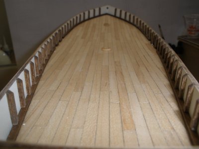

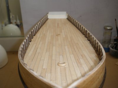

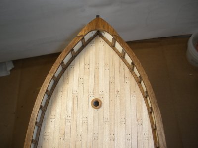

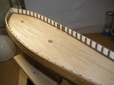

Continuing on, the plans called to simply use the long planking material and apply it to the deck with contact cement. Instead, I opted to make short individual planks (following Frank Mastini's "Ship Modeling Simplified") . Using a small jig (similar to the one by Mastini), each plank was cut to 55mm except for the starting row at the stern. Before laying the planks, 3 edges (fore, aft, and port sides) of the plank were rubbed with pencil graphite to simulate the caulk between the planks. Also, a jig was used to punch the small dimples in the plank's four corners to simulate the pegs holding down the planks to the sub-deck. White PVA glue was used to adhere the planks to the sub deck.
Jig for Plank Cutting
Jig for Punching Plank Dimples
For a 3 stagger pattern, a 55mm plank was laid on the deck's centerline with a 40mm plank on either side and a 15mm plank on either side of the 40mm and then repeated for the width of the stern.
Once the planks were installed, the edges of the deck were trimmed using a rotary tool (Dremel) fitted with a sanding drum. Using a file, the holes for the masts were opened in the deck. The mast dowels were inserted into the holes to make sure there was enough clearance. After this, a light sanding of the planking with 220 grit paper followed with 400 grit prepped it for the several coats of Liquidtex acrylic varnish that were applied to complete the deck planking. I'm considering going back over the deck with a gray wash to give it a weathered appearance.

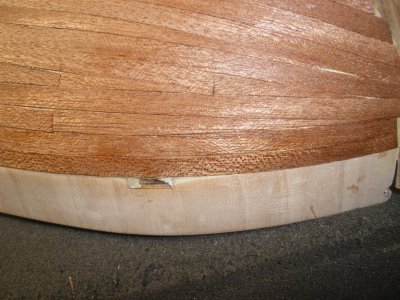

2nd Planking

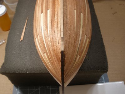

For the 2nd planking of the hull, I decided to follow the Occre plan set; that is, to go the un-tapered plank route with stealers vs. the tapered method I used in the 1st planking. This being my first plank on bulkhead model, I wanted to get some experience doing other methods.
Upon completion, I learned that although the un-tapered method is faster, that whatever time was "saved" was consumed making the stealers. Overall, 18 - 20 stealers were needed to fill the gaps. Whilst making stealers I created a technique to make them which made the process easier and more accurate. I'll share the technique in the next post.
Notably, I did not do that great of a job terminating the planks into the bow keel. As I wrote above, I have a better understanding of creating a rabbet along the keel into which to terminate the end of the plank.
As an aside, the wood for the 2nd planking is very thin (~ 0.6mm) and somewhat brittle so there is danger of breakage, but I found soaking the planks was not required. I chose not to use the contact cement method of attaching the planks as called out in the plans. I started using CA; however, I quickly discovered the wood was very porous and the glue would actually soak through to the top surface of the plank. Instead, I switched to using white PVA and held the planks in place with painters tape. Using PVA gave me a bit of working time to position the plank and the tape secured the plank in place until the glue set.
The wood has a reddish tone which I think would be accentuated if varnish or polyurethane was directly applied. Instead, I applied a coat of Minwax English Chestnut stain (light brown). To the planks above the rubbing strake, I used Minwax Golden Oak stain. To finish, I will use a top coat of Warm Stain polyurethane.

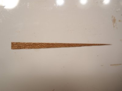

Stealers

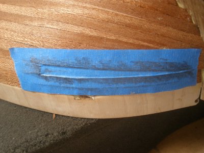

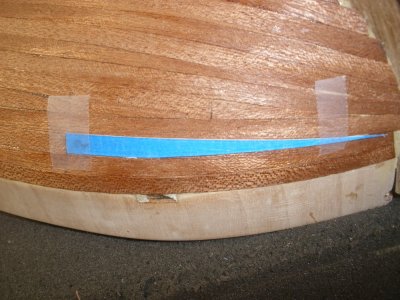

I mentioned above that I chose to follow the Occre plan for the 2nd planking which required the installation of 18 - 20 stealers to fill in the gaps. As I was approaching the end, I found a technique that helped me considerably for making the process a bit easier and more accurate. I'm posting the following from the standpoint of a beginner / novice. Certainly more seasoned builders have other methods, but I found this technique worked for me. My hope is novice builders will benefit from this technique.
Image #1 shows the gaps which needed to have stealers installed. The stealer to be installed is in the lower left of the hull.
Stealer 1.JPGI

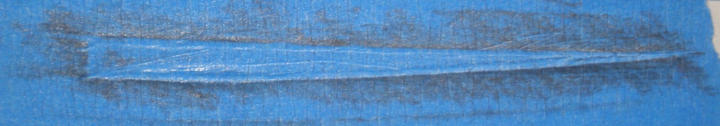

In Image #2, a piece of painters tape (easy release tape) is placed over the gap and burnished to outline the edges of the gap. Rub the edges of the gap with a #2 pencil to highlight the edges.
Carefully remove the tape and place onto a sheet of card stock (60# paper, or equivalent). Using an Xacto knife, carefully cut around the outline.
Next, place the stealer template into the gap to make sure of the fit. Trim the template as needed.

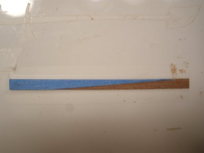

Remove the template and place onto a piece of wood plank. Note, because the planks have some color variation, you'll want to make sure the piece matches the plank the stealer butts up against. Secure the template to the plank with a piece of transparent tape.
Using an Xacto knife, carefully cut around the template. The planking material is very thin and will want to split. Be a little generous with the cut so as to allow for a bit of sanding to create a snug fit into the gap.
When satisfied with the fit, use PVA glue to secure. You may want to use a couple of pieces of painters tape to secure the stealer until the glue dries. The tiny gaps seen in the hull can be easily filled by inserting a bit of PVA glue into the gap and then sanding over the gap. The sawdust will fill the gap.

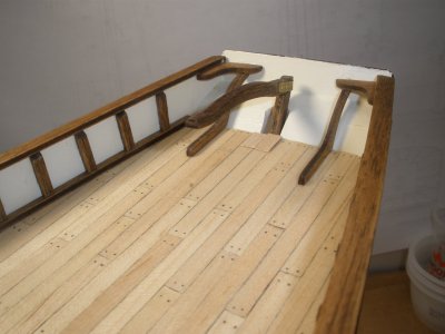

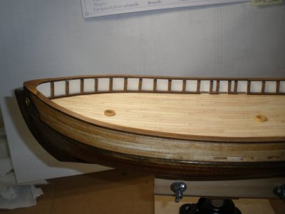

Footrails, Stanchions, and Caprails
The inside of the bulwarks were painted in Warm White as white was simply too glaring. The footrails fit good around the deck and bulwarks. There were no issues installing the stanchions except that the basswood does not absorb the walnut stain evenly (after using a conditioner) and to obtain a dark color took multiple applications. In hindsight, perhaps dark brown paint would have yielded a better result. The caprails come in 2 sections for each side and the bow section. The fitment was not great leaving small gaps. Probably should have spent more time tweaking the fit.

Stealers
View attachment 472161I

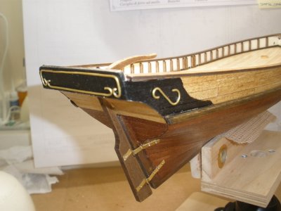

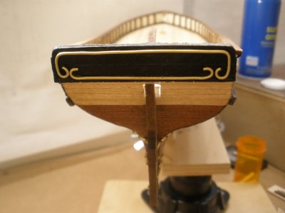

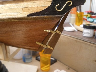

Rudder and Stern Decorations
Assembling the rudder and tiller was very straightforward per plan; however installing the completed assembly was something that I was dreading. To do so involves drilling a access hole through the stern planking. After all the work to accomplish the planking now I needed to make a fairly significant access so the tiller arm can be fed through up to the deck. Admittedly in my exuberance using a small rasp to open up the hole I failed to see I was also removing a bit of the deck planking. Oh well, stuff happens. I glued a couple of small pieces of deck planking to cover up the mistake.
Also, I thought I had sufficiently secured the rudder assembly to make sure that the rudder did not extend below the keel; however, I failed to notice that it had slipped a bit as I was making the attachment points to the hull. I decided to leave as is and make a mental note for next time to be more aware of my surroundings.
I approximated the profile of the black painted area on the port and starboard stern sides onto a piece of card stock (business card) which was then cut out. A piece of blue painter's tape (low tack tape) was applied to both the port and starboard areas. The card stock profile was traced onto the painter's tape and then cut along the line to define the area to be painted.
The stern decorations were made from 1 mm round brass stock. I used several drill bits as mandrels to bend the brass wire into the scroll forms. The brass decorations were attached in place using CA glue.
