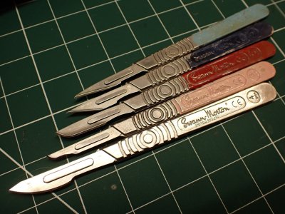

You might try a scalpel. The Swann Morton No11 has a good acute point for this sort of thing. Drill a hole in the middle of your rectangular window space and then carve into the corners with the scalpel.
You will find that the scalpel is not as robust as an X-Acto but that's ok. It's a lot sharper and you will be taking off the thinnest possible shavings so as not to distort those posts.
I haven't used a craft knife for the twenty years since I discovered scalpels (and a little delicacy and patience). Buy the non-sterile ones for cheapness and if you like them buy in bulk. I have five handles with 10, 10A, 11, 15 and the big 23 which cover all of my modelling needs in wood and plastic.
Number 11 is in the pale blue handle.
