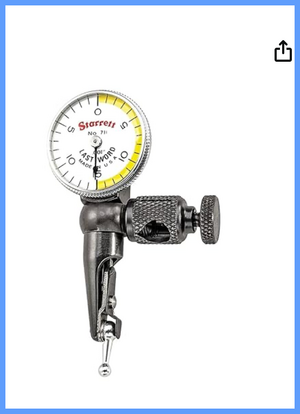

Paul, What I use is my Starrett Last Word Indicator. Mount on the spindle and traverse the x-y axis
A little pricey for some but well worth it. It's smaller than most dial indicators
Depending on the vertical clearance on your mill there may not be sufficient clearance and it may require a different mount location other than the spindle. Works great on my mini mill. If you can mount it on the spindle you will have to 'lock' the spindle so it doesn't rotate.

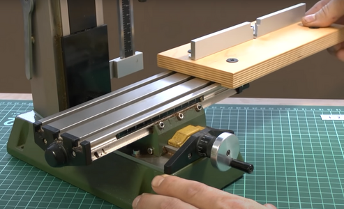

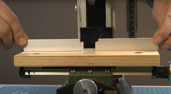

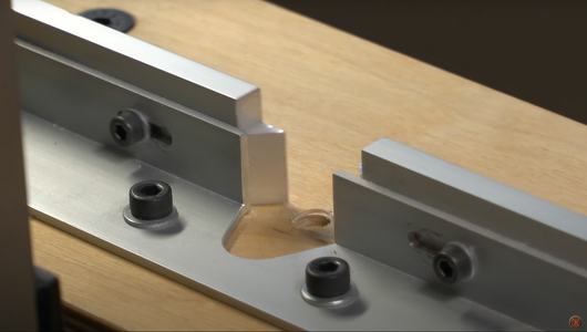

One of the ways, not the immediate one, is to make the jig similar or identical to this (images below)
Here is the video, mostly about the miller itself, but start watching from 11.35 position, Sergey Kutuzov (his name), describes the make of this jig. It is in the Russian language, but self-explanatory. If you need details, I will help you translate,
For immediate resolution, you can mount the straight plank along the 'Y' axis, put the 3mm plank against the mounted plank, find the center of the 3mm part, set the required deep using the 'Z' axis, and.... use your mill as the router. ;)

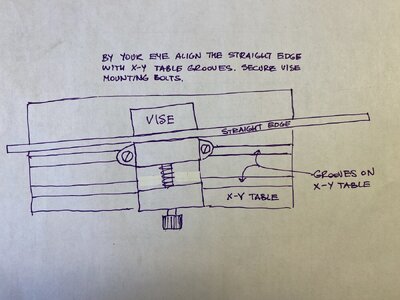

Using the dial indicator as rtibbs descried above is the best true way to achieve parallelism between your working piece and the X-Y moving table. But for a quick adjustment I often set it by gripping the long straight edge (as a steel ruler) into a vise mounted on X-Y table and adjusting the vise position such a way they the straight edge is parallel to the grooves on the X-Y table. Locating the cutter in the center of 3 mm wide plank for cutting a slot along the plank I do by eye too, but often with limited success. I mark the center on the working piece with a pencil first.
Thanks, Ron. But isn't that used to level the table??? Or maybe I can't imagine how I would use that gizmo to solve my problem.
Thanks, Jim. That might do the trick. I'll take a closer look. I can imagine the fence being in the way as shown but I don't need to use a fence that is that tall...
Thanks Yuri. Could you take a photo of how you are using a vice? I can't quite imagine this in my head.

Unless I misunderstood your question I thought you were wanting to cut a long slot along the piece. If so then you would have the indicator fixed and indicate along the piece as you moved the table and adjusting the piece until the indicator showed no runout.
Maybe I confused you by saying attach the indicator to the spindle. ( I did say you would have to lock the spindle from rotating)
Tramming the table is something you would do with the indicator mounted to the spindle then rotate it 360 degrees to see the head was aligned to the table.

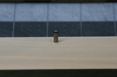

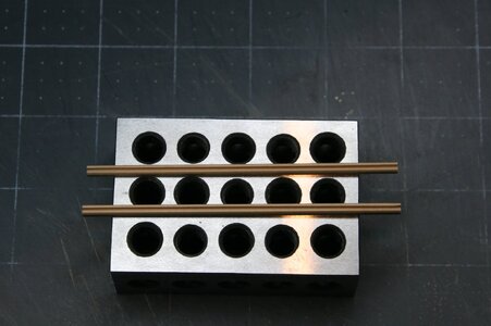

Thanks to everyone who has been contributing to (or just reading) this thread. I thought I would give you an update on some of my current solutions...
First, I took the shaft of a broken mill and set it into a flat piece of wood. I'm sure you've seen this solution before but just in case you haven't ... what you do is set up the post relative to the milling head and slide the workpiece along the post. These keeps the 'cut' in the same place along the workpiece. I used something similar to cut a rabbet and it worked fine - but if the workpiece is long it's hard to keep it up against the post over the full length of the cut (but not impossible):
But what I wanted to show you is this...

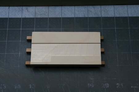

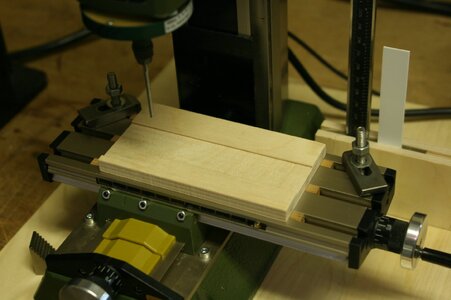

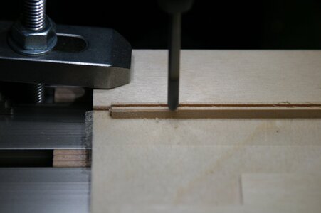

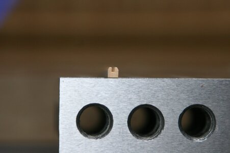

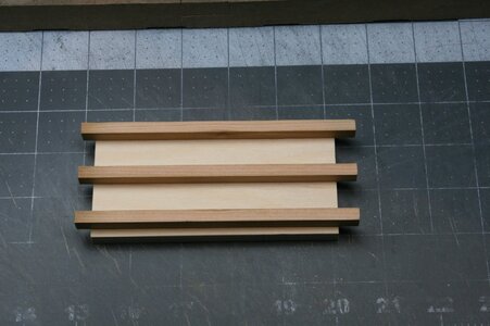

I made a 'sled-looking' thing with guides that sit (perfectly) into the slots on the XY table. I then milled down about 2/3rds of the surface 2 mm or so. Now, whenever I return the jig to the XY table, the left to right 'fence' is always perfectly aligned.
Proof of concept:
Next, I'll add the suggested edge finder. And I'll also continue to explore other solutions for other applications.
