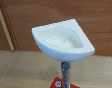

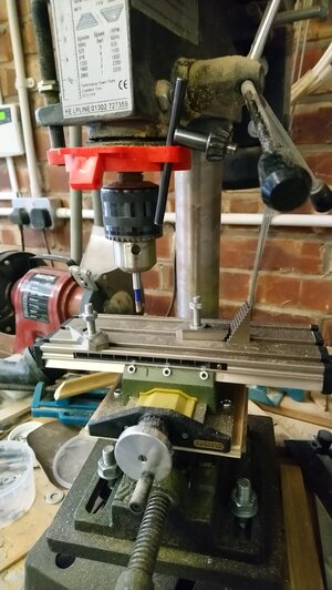

Thought I would add my two pennyworth. I have just bought a Proxxon KT70 milling table (yesterday), although I do not have a Milling machine and fixed it to my Benchtop pillar drill. I will also use it with the much smaller Dremel 220 workstation I have.
It needs some practise but I produced my first piece from 20mm sq MDF block, a corner wash bowl for a Dolls house I am making. Just got to figure out how to move in the Z direction in a more accurate way as there are no micro screws to move the drill head up or down, nor for that matter the table clamp. Also need to buy some smaller milling heads as I just used the smallest router bit, which was 4mm. The outside of the bowl was sanded not milled.

Yeah…you will do well with this mini machine! It will take practice to get things right but that is expected. This is the kind of tool that if you do not have one you don’t miss it…but when you do have one you don’t understand how you ever did things without it. :)
