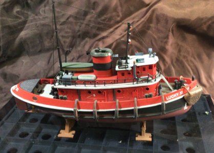

One of my boredom builds while camping.
Nice job!
This Revell's tugboat is also on my list, but I would like to transform it into a real tugboat model, she had long and interesting history and still sailing, although converted to a pleasure craft. :cool:
As for your initial question - honestly I don't know. Looking at all these ships moving in and out of the port, coming from the horizon, anchoring and then leaving - it gives a specific inspiration to make a model and put it on the table. :D
That tugboat wasn't on my list, but I've just added it. :cool:
