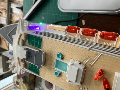

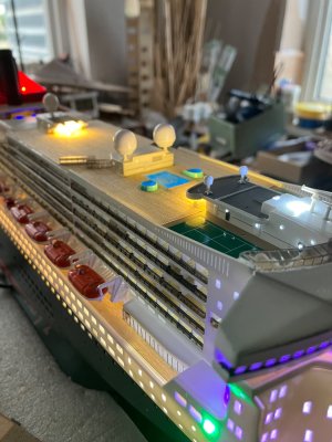

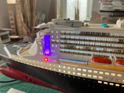

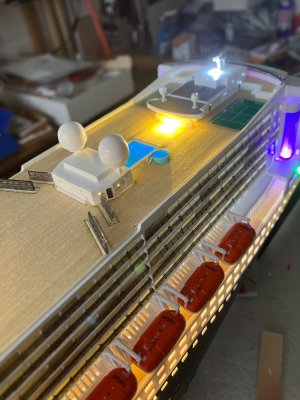

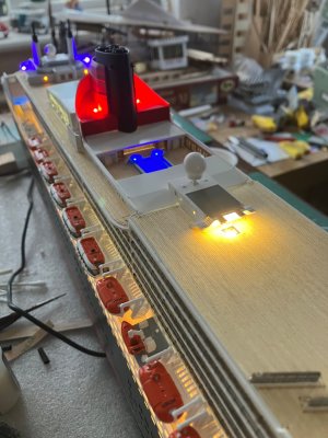

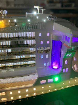

Little more various deck work. Still loads of trial fitting and night time light testing before final placement.View attachment 621547

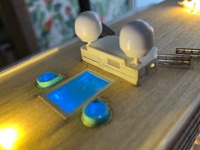

Only discovered a few days ago that new clever electronics on led lamp bulbs now come with built in resisters in the actual bulb. Incredible View attachment 621546View attachment 621549View attachment 621550

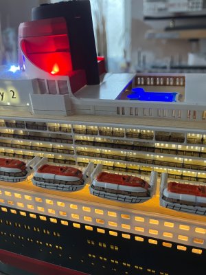

Also been using this product for most of the smaller glazed windows, etc. Great stuff , looks the biz. View attachment 621551View attachment 621552View attachment 621553View attachment 621554

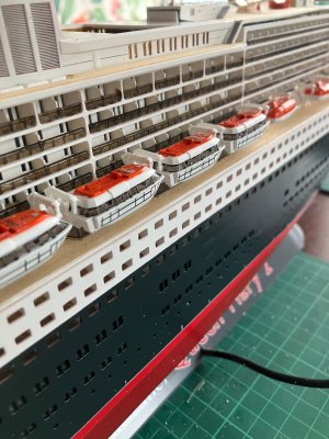

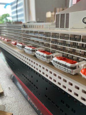

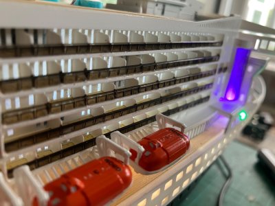

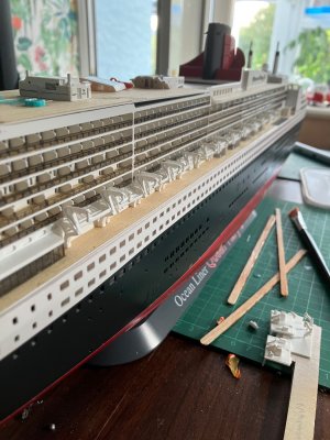

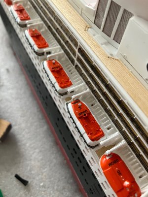

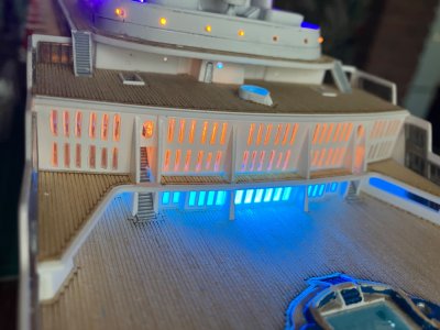

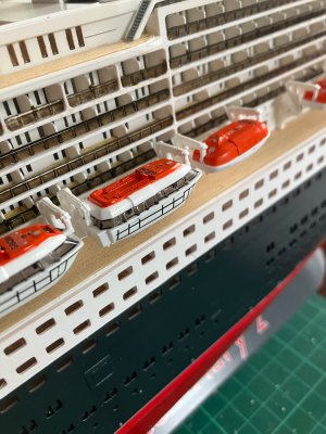

Now the really boring tedious job of the superstructure sides . Individual decking to place. This is not with the kit but an after add on product. Then obscure plastic sheets on the insides, then several black outs to give some cabins lights off effect. Oh then smoked plastic railings on each.
So boring but looks good. View attachment 621555View attachment 621556View attachment 621557View attachment 621558View attachment 621559

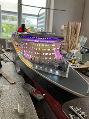

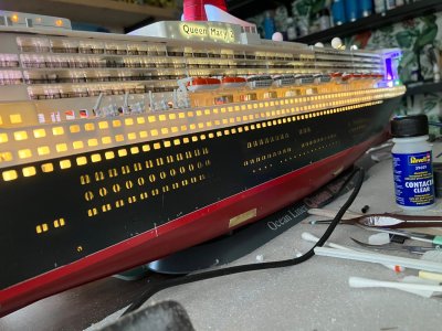

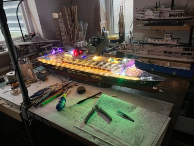

Superb build. As a matter of interest, how many led's have been installed? :)

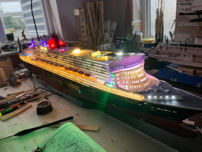

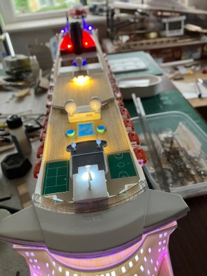

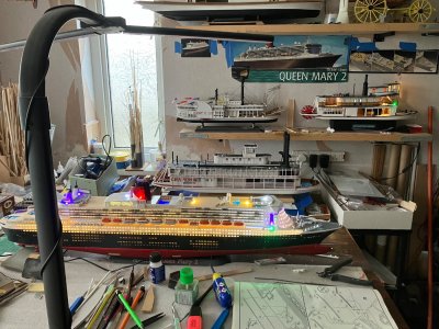

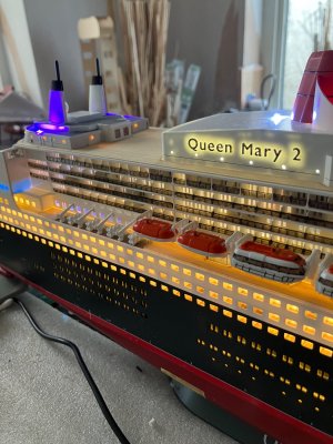

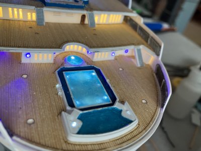

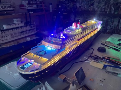

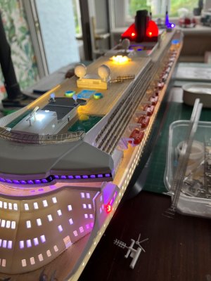

Hi Neil.
So far to date….. 11 smds. Purple, clear white, Blue, red and green. To highlight the lifts, navigation, funnel and vent stacks.
Two long strips of led tape lighting for the main hull body lights and a small length to light the Queen Mary 2 logo name.
Five 3mm LEDs (different colours) to power the fibre optics dotted around the ship. (Swimming pools, spas. Etc.
Fibre optic strands are .75mm.
All running on 12v mains adapter.
Hope this helps.
Few more to go……

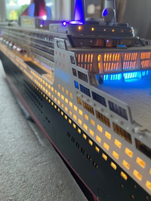

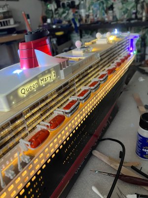

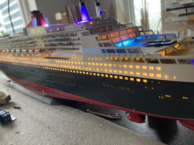

Nighttime pics. A bit of glare from the iPhone.
WOW!! No disrespect to "plastic" kits Neil, but you really have elevated this to a new level! A fully illuminated ship like yours would grace ANY home or office. :) Thumbsup

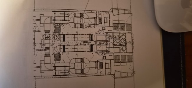

Here is the orientation book that we used during the construction of the Queen Mary 2.
It shows every deck and fire zone throughout the ship from the keel to the top of the ship.
The top image is of the gas turbine room on deck 13.
Enjoy.
