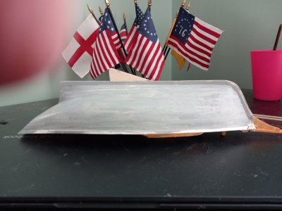

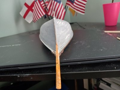

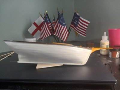

I primed the hull with acrylic primer. Now the finish coat bleeds into the primer. I am going to finish this one then reorder the same and try redoing it with the knowledge gained from the goofs on this one. And without acrylic paints! I now know where the week spots are on the stem, and will reinforce them before adding the bulk head framing. Though I may just go to my local hobby shop and pick up some Testor's oil based paints.
Some of the glues I tried that were not so good.
The Evergreen yellow wood glue works very well.
