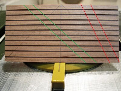

If you have a small circular saw you can make the stairs in this way - I guess the photo session is explaing already the different steps
View attachment 442163 View attachment 442164
View attachment 442165 View attachment 442166
In 1:100 it will be hard to make, but maybe possible

Your way of making stairs is much better comparing with my option of cutting each plank (for ladder) separately. All in all they were not so equal.
Can you please tell me, it also works for angle of 60° or only 45° as you made ?.
Regards Pawel

you can choose every angle you need
