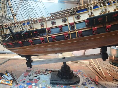

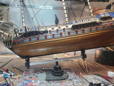

I use an Amati keel clamper screwed to my bench. I drill the keel when fitting and put long screws in to hold down. Have never had a problem with keels cracking or breaking. I even have on my bounty that has been copper hulled. The clamp will not lift the plating so long as remains in the position first fitted.
