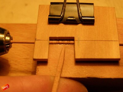

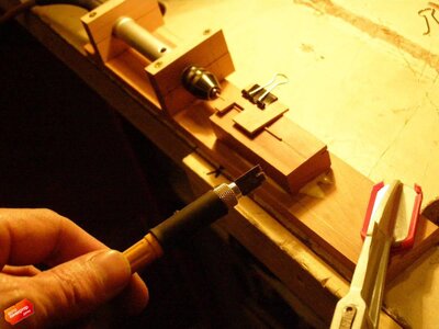

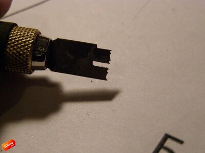

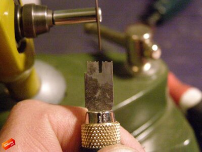

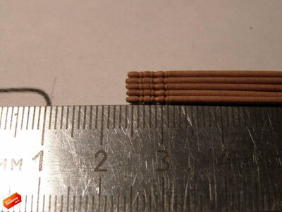

Alternatively, you can make a cutting tool in the shape of your baluster and turn on the wooden lathe. The tool can be made from an old\dull Axacto flat chisel. Below is the photo of the tool made by Sergey nick @bibigon He made this tool for the ship's wheel parts

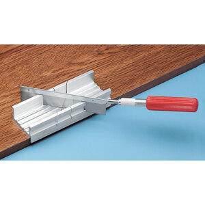

You need a modeling miter box and a razor saw. MicroMark has them.
