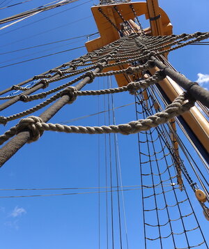

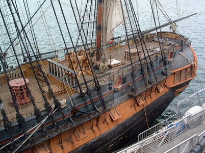

No, they are not tarred though there is a tar content in the lines. Victory has natural ratlines, the Surprise at San Diego has black!! Your chosen colour is a matter of preference. Split the difference? A plain hemp line can look fairly dark. I think the important thing is to make sure it doesn't appear too 'white' in photos of your build, a realistic dirty grey brown would look better.
I use light tan for ratlines, & I've read they were not tarred, although shroud lines were.
