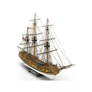

Does anyone have a detailed set of rigging plans for the Rattlesnake they’d like to get rid of or sell? Or a place to purchase? My Google searches have gotten any meaningful results. The Model Shipways plans seem a little sparse and I don’t yet have the skill set to ’scratch rig’ it myself. Some of the build logs on this site are amazing and helpful but the builders seem to already know where everything goes.

Does the Lauck Street Shipyard rigging instructions include a belaying plan for all running rigging lines used when the sails are set? The Mamoli kit plans rigs the ship with no sails.

What you need in addition to "Rigging Period Ship Models" is a belaying plan. This plan shows where the working ends of the lines are tied off to on belaying pin racks, cleats, and railings. The rigging instructions for the Mamoli model of Privateer Rattlesnake can provide most of the belaying points for the running rigging lines, but for the ship without sails set. If you fit sails, bowlines and tack lines are some of the lines that you will need to determine where to belay them. Lennarth Petersson's book can provide good guesses as to where a certain line is belayed, but there were no solid conventions, and each ship often had its own belaying arrangement. It is common for modelers to rely on guesswork for belaying locations, when they only have partial rigging information. As far as belaying plans go, different model kit companies provide different belaying plans for the same model ship, adding to the confusion, and the choices you have to make in building.
