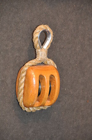

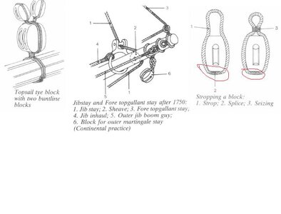

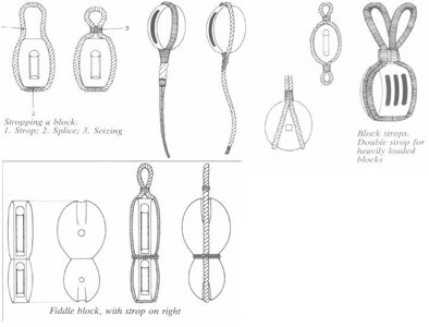

I cheated when I did mine. I too used hooks and eyes for the terminal ends of the block and stropped them with black thread with a bit of PVA glue. But then again I wasn't looking for perfection, just representation. The eye sees what the eye wants to see. Hope that's a help.
Thanks for sending the illustrations and photo of blocks stropped with line/thread. They appear to be larger than the smaller ones that I want to strop with wire/metal. I thought of making a wire hook with a closed eye end which could be stropped with wire or line to the end of the block. The same may be feasible with a hook on one end and an eye/thimble on the other but the diameters have to be at 1 mm or less. I'll use these suggestions and keep my dock open for others. Thanks again, Rich (PT-2)

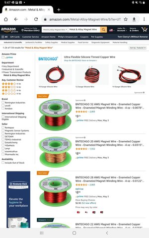

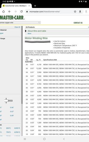

So. What I think you need to consider is motor winding wire. McMaster Carr carries a lot of sizes. Give it a look.
MacMaster is very expensive, IMHO. The store serves mostly professionals and big corporations in tools and materials. There places you can get much cheaper copper\brass and steel wire in many different diameters. Check this store, it has a galore of different wires.

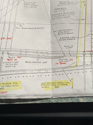

Thanks for the suggestion. My problem is with making hooks that are proportionally smaller than the block, even at the 1:64 scale (3/16" = 1'-0") so I need hooks about 4 inches long in that scale yet strong enough not to pull open under rigging tension of the boom tackle that is hung beneath the Bluenose schooner booms. Here is a photo of the elevation drawing showing this tackle and the size of blocks suspended below it. The blocks' sizes are noted and give a clue as to how much smaller the hook needs to be.Foreboom Tackle Rigging.jpg
The main boom has a similar suspended tackle which is about three times longer. Rich

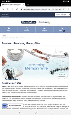

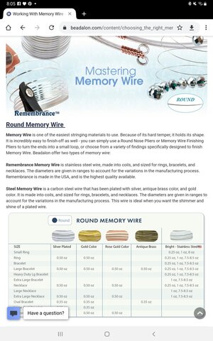

So. There is wire known as memory wire. I buy it at Hobby Lobby. It is a hardened wire available with different platings. The stuff I have is .025" diameter. It is very durable, somewhat hard to bend. It will retain its strength once bent. It is made by www.bendalon.com and they have a pretty good selection.not expensive at all. Maybe give it a look.....Screenshot_20210504-200511_Chrome.jpgScreenshot_20210504-200541_Chrome.jpg
==So. There is wire known as memory wire. I buy it at Hobby Lobby. It is a hardened wire available with different platings. The stuff I have is .025" diameter. It is very durable, somewhat hard to bend. It will retain its strength once bent. It is made by www.bendalon.com and they have a pretty good selection.not expensive at all. Maybe give it a look.....View attachment 231372View attachment 231371
I will check this out at the local Hobby Lobby and try to get a feel of it. Thanks, Rich
