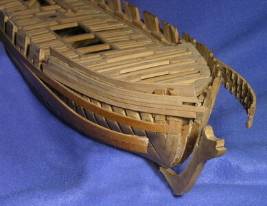

Hi Dave. What type of wood and what glue don’t work together? What wood and glue were used on that model in the photo?

the framing was in the family of what was being sold as Castillo Boxwood which is any number of woods the trade name is a catch all for different woods.
Farinha Seca, Guatambu, Guatambu Moroti, Guatambus Blanco, Ivorywood, Kyrandy, Marfim, Moroti, Pau Liso, Quatamba
The wales that let go were Peroba which again is a "family" of woods.
The glue was 5 minute Epoxy
it took a few years before the model fell apart a long, hot, humid summer caused the epoxy to break down and because the wood was very dense the glue did not get absorbed into the wood. The Peroba wales are not only dense but has a lot of resin oil.
At one time rough sanded (80) grit was considered not smooth enough for model work (120) grit finish was thought to be the best. The proble when you give hardwood a fine finish the harder it is to glue.
