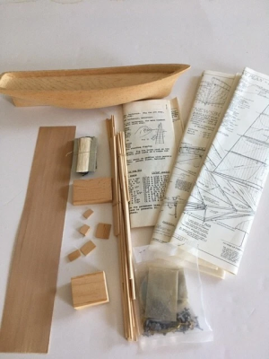

This is a model of the hermaphrodite Brig N e w s b o y (1854). Likely built from the Model Shipways kit. It was produced in their early "yellow box" solid hull era and later in (I believe) a "knocked down" plank on bulkhead version (AKA an "IKEA kit.") I am uncertain whether Model Shipways still has their N e w s b o y in production. They should most likely have the kit instructions available still. (See: https://modelexpo-online.com/model-shipways-historic-model-ship-kits and https://modelexpo-online.com/parts)
(See: https://www.ebay.com/itm/167545427768?mkevt=1&mkcid=1&mkrid=711-53200-19255-0&campid=5338678874&toolid=20006&customid=783fbf8866ec1fcdcda5d7c0eb68dfc1||&gclid=783fbf8866ec1fcdcda5d7c0eb68dfc1)
The French ship model kit company, LeClerc, also produced a N e w s b o y kit with which I am not familiar:
N e w s b o y is a particularly attractive model, providing at 1/8" scale a lot of interesting detail as she was only 111' long in real life. Her foremast provides the interest of square rigging without cluttering the overall presentation of the model with complex square rigging on both masts.
