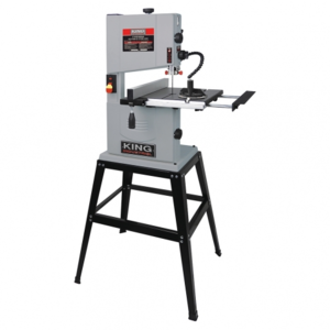

My Rikon 10" 10-3061 bandsaw is backorder since 1,5 month and will be another couple of weeks. I canceled the order and need a good budget replacement bandsaw. I have eyes on the King Canada KC-1002C wich is 10" but at lower, so I would like to know if this bandsaw is good enough for modelism, and medium homework and resaw at scale for 10 " ?
10" WOOD BANDSAW
  • 10" Wood bandsaw with stand
  • Quick release lever blade tension system
  • Adjustable upper/lower ball bearing blade guide system
  • Cast-iron tilting table with built-in retractable extension
  • Flexible LED light increases workpiece visibility
  • Rack & pinion height adjustment system
  • Dust chute accepts 2", 2-1/2" and 4" dust collector hoses
  • Comes complete with miter gauge, rip fence, adjustment wrench and hex. keys
    • CUTTING CAPACITY FRAME TO BLADE9-1/2"
    • MAXIMUM DEPTH OF CUT4-1/8"
    • TABLE SIZE13-3/8" x 13-1/8"
    • TABLE HEIGHT FROM FLOOR41-1/2"
    • BLADE SIZE67-1/2" x (1/8" - 1/2") x 0.025"
    • MOTOR1/2 HP
    • AMPERAGE3.4 Amp.
    • VOLTAGE120V, 1 phase, 60 Hz
    • SPEED2,750 SFPM
    • ASSEMBLED DIMENSIONS (LXWXH) / WEIGHT26" x 20" x 58-3/4" / 91 lbs
    • PACKAGE DIMENSIONS (LXWXH) / WEIGHT34-3/4" x 15-1/4" x 18-1/8" / 95 lb
Thanks for any advice. Other stuff is really out of budget, I do not want to pay 1 K$.

Any well tuned band saw will do a good job. Just remember for modelling you will also require sanding (or planing) as no matter how good the bandsaw is tuned and how sharp the blade's teeth are you will always get saw marks on the cut pieces. I have a very cheap 10" bandsaw that I spent several hours tuning and now runs and cuts very well. There are a lot of Bandsaw tuning videos on Youtube- I recommend you take the time to tune the bandsaw properly straight out of the box to avoid frustrations later.
I've never re-sawn wood with the 10" as it has a permanent fine blade installed, I use my 14" bandsaw for that.

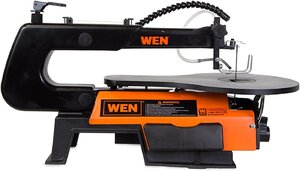

For really fine stuff I would also recommend a nice scroll saw that allows you to get much closer to the cut line and sanding can be much quicker.
Thanks it is appreciate. I purchased a WEN Scroll Saw (WEN 3921 16-Inch Two-Direction Variable Speed Scroll Saw ) with Olson blades (Pin end and plain end). I will received it in one week. I also purchased the Big Book of Scroll Saw Woodworking by Fox Chapel Publishing for the pleisure of exploring all the possibilities of my new tool.
I have also an eye on the King KC-1202FX wich is similar in price and concept as Rikon, but 12 " with 6 " resawing capacity.

Well, I rethink my project and purchased a Wen scroll saw, a king belt and disc sander and finaly a king 9" band saw that I Just finish to setup and niveled corectly. I followed Donfarr advises and taked time to setup all these Things, for the price of the Rikon.
