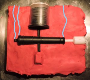

I have tried to draw on your photo. The lines are too thick and wavy but I hope it conveys the idea. In addition to this, you can "burp" the mold to get the blocking air out. The vents will allow the resin in and can be cut after the mold is made or added with lengths of plastic rod as you make the halves. I used to glue fine plastic or brass rod to the high points of the master from the surface of the mold prior to pouring.
I have cut vents into molds where air gets trapped I also used plastic and brass tubes to create vents.
what I am trying here is not having vents just to see if the mold will cast I am thinking in a vacuum it should suck any air out of the mold cavity. If it does not work I can always go back and cut vents.

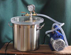

I found out without a vacuum pot like this one you have to design the molds so they will cast by using air vents as well as "burping" the mold like a baby or injecting the resin.

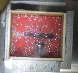

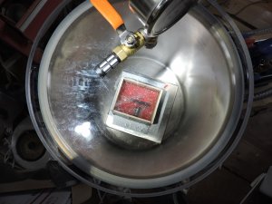

the first half of the mold was cast in Silicone and here it is in the vacuum pot. first I mixed the silicone and degasses it then I poured it into the mold and put that into the pot and sucked out the air bubbles. you can see the air being sucked out
looking up close

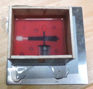

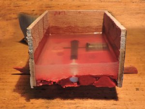

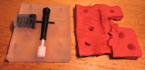

here is the first half after it set up clear and free of bubbles and an OOPS! the mold leaked a bit.
now I remove the clay and clean up the silicone mold half
next step is to add the sides and paint the mold with a rubber to rubber mold release if you don't do this the mold halves will stick together and you will have to cut them apart.

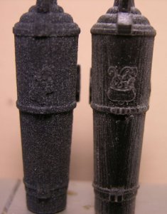

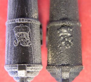

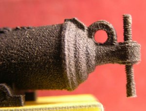

here are some examples of 3D printed carronades and you can see what the quality is. Some are from places like Shapeways others are from other services. Now I have not tried all the different materials offered so these are an average print. I am sure the more you pay the better the quality

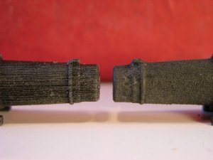

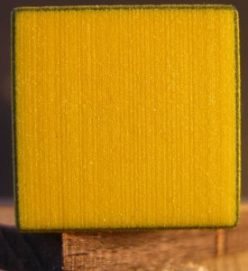

different materials produce different results

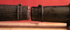

different resolutions produce different detail quality
different material different results in detail
depending on how much your willing to pay will give you sharper prints

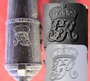

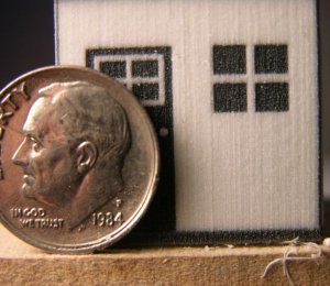

you get what you pay for a cheap $8.00 print looks like this
middle of the road cost for a print is usable still expensive but passable.
to cast or not to cast? pay for a high end high resolution resin print and make a silicone mold and cast the cannons

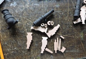

Working on kit projects with model ship builder like the battle station kit and the new bomb vessel kit and more in the design stage we decided these kits have to include guns because most kit builders do not have the resources, machines and software to make their own.
it is one thing to make a gun or two and a totally different story to mass produce them.

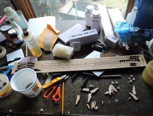

here is a work area I am using different types of resins and different molding materials

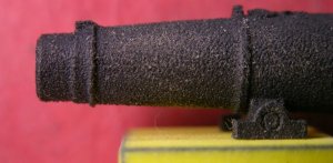

what I am finding out if you tint clear resin you do not get a solid opaque it is somewhat translucent but I did find out if you paint the casting with a matt heat paint it gives the cannon a perfect scale looking texture. I could buy a pre tinted black resin but early tests with this gave a glossy surface and it did not look all that good.
here is a cannon for the Blandford X section model if anyone is interested in these cannons they are available.
