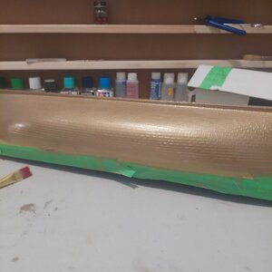

I had learned of munz being the anti fouling used. I settled on using testors gold enamel. I brushed on a thinned coat. Not sure how many applications I will require, nor how long I should wait between coats.

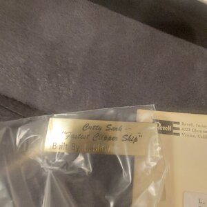

The last image is a custom nameplate that Revell offered which my uncle sent for. I will attach it the base for him.

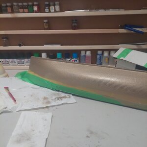

I gave the hull 1st coat with very thinned enamel. I went over it after an hour with a slightly less than a 1:1 thinner to paint ratio. It went on ok but was not going on very smoothly as my brush unloaded. I will leave it be for a few days.
The deck I am not sure how I am going to approach I tried the recommended black base coat and sanding back the deck tan to expose the raised details.
I did not like the look. I think my sanding stick was too aggressive and wore more than I intended. I sprayed with tamiya XF 78 deck tan and will have another go. I am curious what other options would be viable.

Any latest developments? Painting multiple layers of different colors like: base of black, then a coat of dark tan, then a coat of light tan. Then as you lightly sand the hull, the various layers of paint will reveal until the darker (grain) will start to show through. If that makes any sense.
