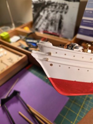

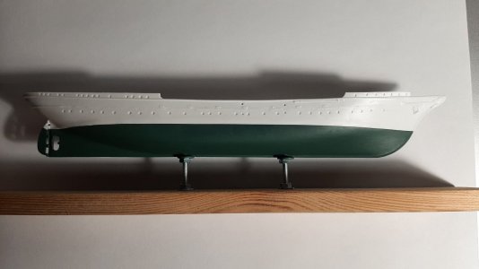

The current state of the build is as follows:
- some sanding is done to smooth out the hull lines and remove the details, specific to Gorch Fock 2
- the hull under the waterline is painted green (the paint comes with the kit) with brush
- the temporary stand is in place now
While I am working on the upper part of the hull, I am coming to a first big compromise with the kit as a base - the portholes. Of course, there are differences between Gorch Fock 2 and Tovarishch making the last one recognizable - I marked them with blue. But the portholes.... Revell's version does not correspond to either, Gorch Fock 2 or Gorch Fock 1 - sometimes closer to one, sometimes to another, sometimes is something new :D Take a look:
After reviewing this, I decided to leave the portholes with a black dot inside and make 6 new ones where you see a black circle. Others will be fixed with putty - and this is the compromise. :confused:

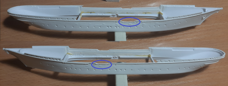

An intermediate point in the process - I think I've made a mistake in the central area of the hull (red and green frame). Unfortunately, I don't have plans for my target period, only much earlier plans for Soviet era, about 70s and I have an existing plastic kit I am trying to adopt. So after checking a lot of drawings, photos of different years and at this moment, as well as applying Revell's deck to my hull, I think I came to final positions of the portholes (in the middle, v2, green):
Still working on the hull, I got quite a surprise when I realized that it is asymmetric: port side and starboard side are different!!! :D I will put it here if someone decides to follow - just to be aware:
But now I think I am ready to put all of this in place. The black lines, circles, rectangles reflect the changes I am going to apply to Revell's hull. The starboard side (7 portholes on the forecastle, ending 3 on the poop and so on):
The port side (9 on the forecastle, ending 4 on the poop, etc.) - the orange areas have scratches I occasionally made and missed:

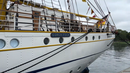

It depends on how the portholes are looking in real life. Usually the brass is used for portholes fittings so in many kits and prototypes, especially for late XIX or beginning of the XX century you can see a brass ring around the black porthole:
But in my case at least only the black rubber is seen outside the porthole, while the brass fittings are visible only from inside:
PS
This is Gorch Fock 2, but very detailed:
PPS
On J.S. de Elcano it is similar:
So you will and I will both paint our portholes black. But how will you go about it? Sharpie? Paint brush? Charcoal pencil? I hope to find a method that is effective to show that the potholes are there, but without risk that I might screw my hull paint job if I make a mess of it.
I will paint them black using a thinnest brush I have, like in this video (video is not mine, to avoid any confusion):
A tooth-stick can also be used, if you don't have a brush.
But in your case, when the model is almost assembled, you can try to use Stabilo 0.4mm markers instead

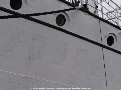

Thus I spent a lot of time trying to find the right porthole positions, using the ones provided by the Revell kit as a base, to minimize the amount of work but make her recognizable. I was trying to move them left or right, but it was always wrong :D But finally I noticed one thing, which gave me a clue, and I want to share it with you.
First, portholes on a steel-hulled ship can't be cut out in any place, like in the wooden hull of the XV-XIX centuries, by cutting through parts of the frames, like this:
In steel shipbuilding, portholes can only be placed between the frames. never through them, as can be seen on these photos of Gorch Fock in Stralsund:
So there is a minimum spacing, and each subsequent porthole is positioned at 1x, 2x, 3x that spacing, and so on. Then I looked at the hull again and noticed that there are 12 portholes on both sides in the middle of the hull, with the same spacing between them. The only difference between the starboard and port sides is the presence of additional portholes inserted between them:

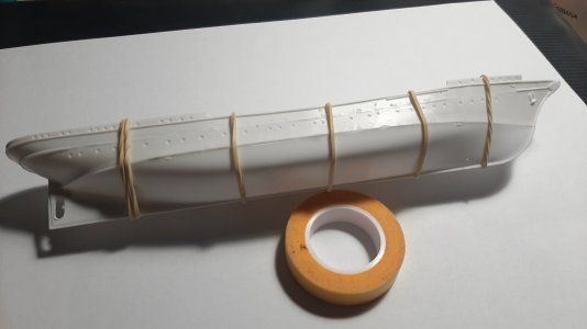

Second, I've updated the hull:
  • marked the porthole positions using the masking tape to maintain a single line

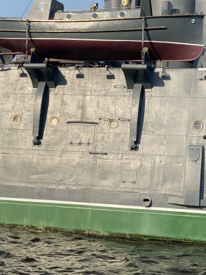

  • made two cut-outs in the middle of the starboard and port sides
  • extended the board with small pieces of plastic from sprue to round the corners later with a file:
By the way, these elements are still present on Gorch Fock in Stralsund (like you can see here), making it obviously different from Gorch Fock 1933. I guess they needed them due to the large heavy seas lifeboat installation. Just imagine: you can't release it without hitting the board otherwise!
The lifeboat was removed in her soviet period of service, but the board is forever cut out and this makes me thinking about her life and destiny. What do we have now in Stralsund? The same hull, steering wheel, many other things - so she is still living, and great thanks to all the involved enthusiastic people for that!!! But she is not the same as she was in the 30-s as Gorch Fock, neither Tovarisch of the 70-s - all her previous life was wiped out by the time and people, and in our days she became something new, but not a model of herself before...

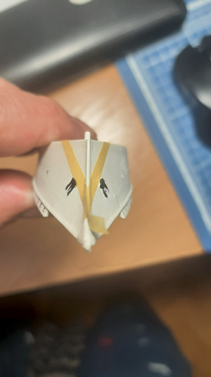

Finally, there were two updates on the bow - the figurehead and bobstay fitting (also made from sprue):

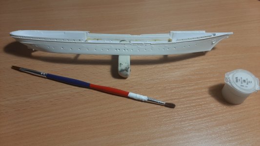

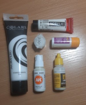

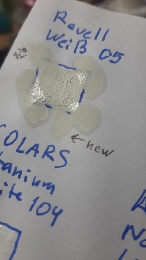

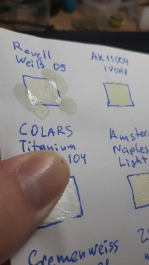

Next step is painting the hull. Officially Revell recommends their color 05, White matt.

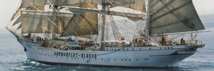

Looking at the hull it does not seem snow-white, but a kind of slightly yellow warm white to me, like on this photo, where the white paint, recently added to repair, contrasts with the basic color:
Definitely not that white as Gorch Fock II or J.S. de Elcano above

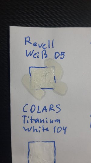

So I decided to try several paints I had at home and choose the right one.
And finally I decided in favor of Revell's 05 color and applied it using the Revell's brush, coming with the kit:
Honestly, I am not happy with the resulting porthole positions - but making them closer on the starboard side could be dangerous due to the initial kit positions. So, another compromise.

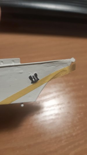

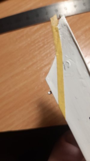

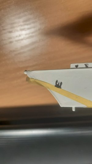

I would call this post "Operation Anchor - 2026" :D

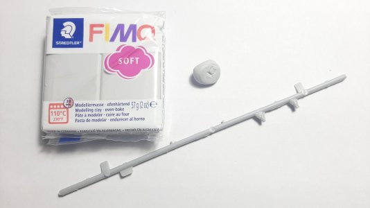

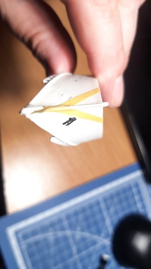

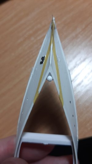

During all her years of service she was a training vessel for marine cadets. I think this is why she had only one modern anchor and a second one - an old-fashioned admiralty anchor to train its catting and fishing. Due to that, Revell's kit comes with an empty place for the port side anchor, which wasn't the case of Tovarisch. So the question was: how to duplicate the starboard anchor as if there were two from the beginning?

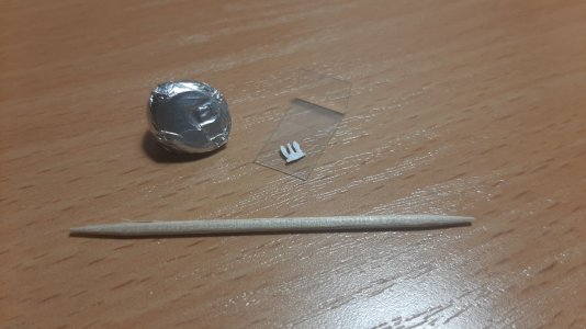

The modelling clay was my solution. I took the shape and baked it as described in the oven, thinking to use the sprue to fill the form.
I don't know, guys, if you ever tried, but my experience with the melted sprue (using a candle) was a total loss of time! :D
Then I came to the idea to use putty - to fill the form and when completely dry. just paint it over! I covered it with the foil, and this is the result (a tooth stick is just for size reference):
Then I had to glue it to the board, but it should be at the same level and and the same angle as on the opposite side, so using the masking tape I set it up:
This is the final result to this moment:

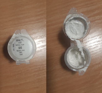

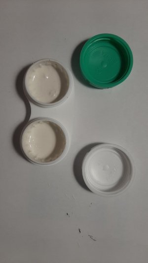

This time I have to ask for your help and advice! This is what happened to my Revell's 05 White matt paint! ROTF
It hasn't dried completely, there are still some wet places, so probably it is not completely lost. Did anyone tried to dissolve this type of the paint?
First problem is that I've started using it already and I don't want to repaint the hull (probably, I would do) - because I need to fix several places around the portholes and the anchor and I don't want different shades of color to mix.
Second problem - it is an "aqua color" paint. but I tried already (maybe I did something wrong) - it does not dissolve in the water. I can wash it with 96% alcohol, but I'd like to hear your opinion first.

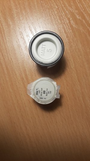

Finally, there is an enamel paint from Revell with the same name and number, but I haven't used this enamel yet and it is too thick for a brush (I don't use the airbrush due to home and family limitations). Is there a way to lightly dissolve it to use with a brush?
Thanks for any advice and suggestion! Beer
I've tried the new (enamel) paint. Good news - it is absolutely the same shade! Thumbsup
Bad news - it is glittering when it comes over the old "aqua-color" paint - remaining matt in other places!!! ROTF
I think the solution is found - the 96% alcohol dissolves this type of the paint, even if it is completely dry. I took all dry parts from its sides and dissolved with a bigger amount of the liquid.
