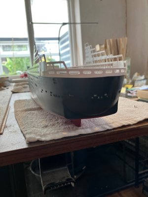

Revell Queen Mary 2. 1/400 with added led lighting.

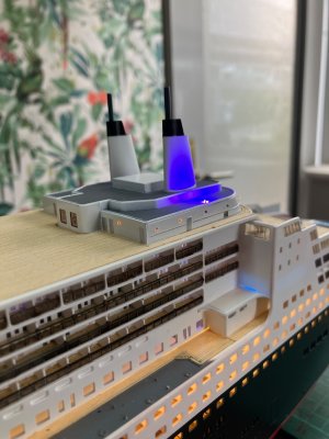

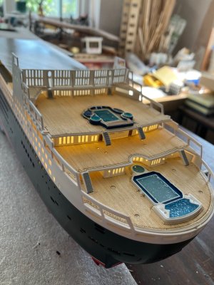

Great to see another build from you, I'll watch with interest. I think the LED lights will look stunning...

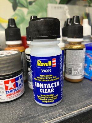

What type and mfg of adhesive/glue are you using? I really like what you are doing with the LEDs. What voltage will you be using? What are the details on the fiber optics. Voltage?

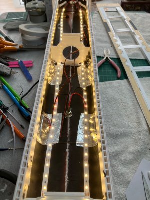

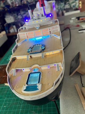

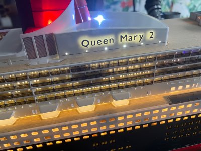

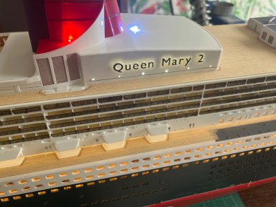

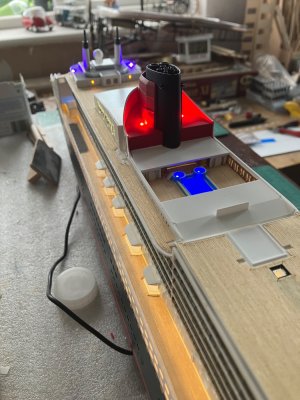

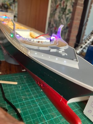

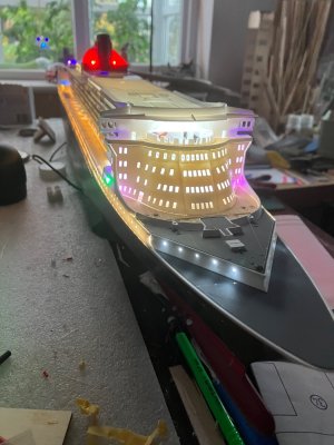

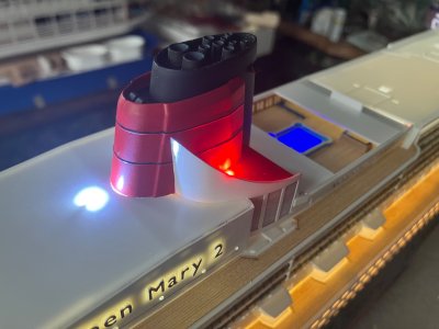

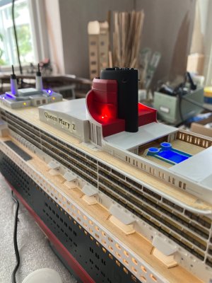

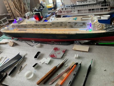

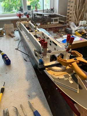

Little update on the Queen Mary 2.

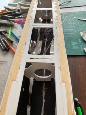

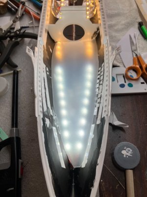

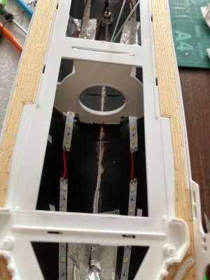

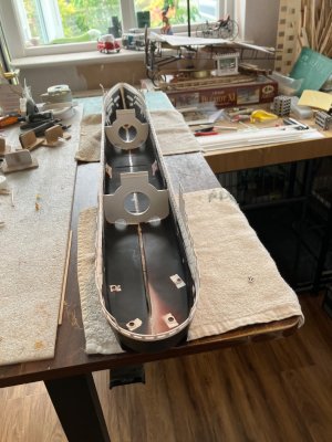

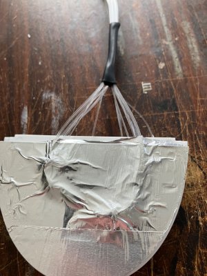

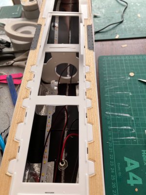

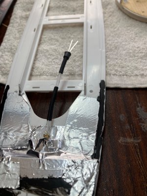

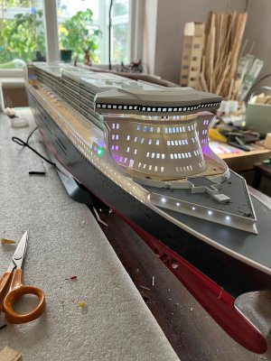

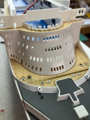

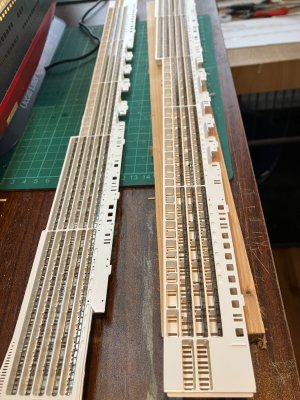

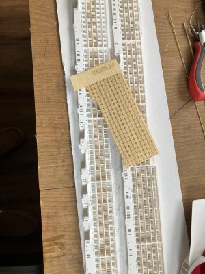

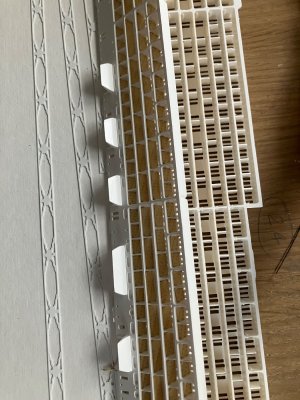

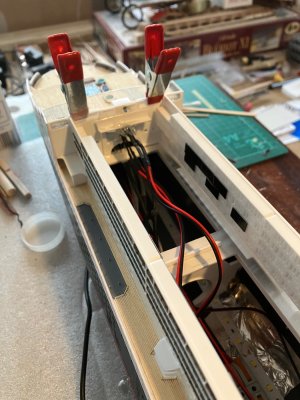

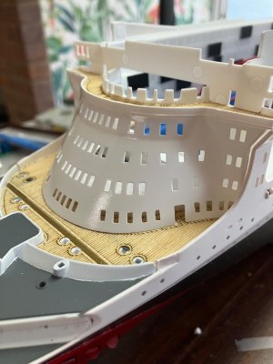

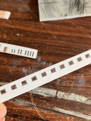

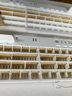

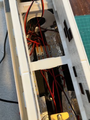

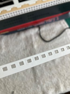

Biggest problem so far is light bleed. Have to do a bit then wait until dark to check how much is leaking through.

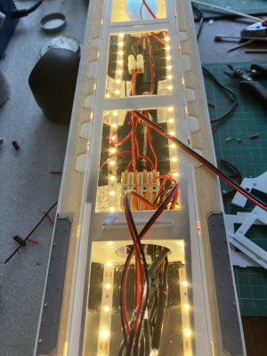

Loads of foil tape everywhere to prevent it.

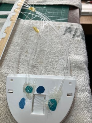

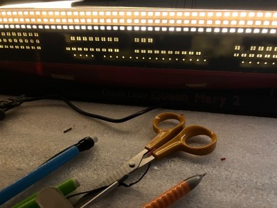

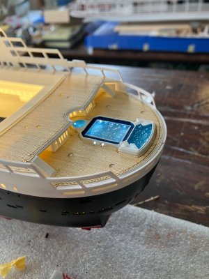

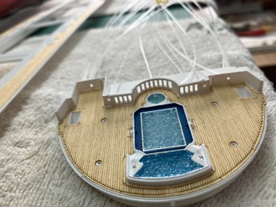

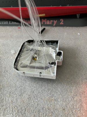

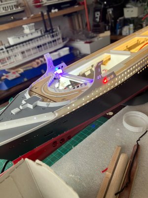

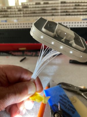

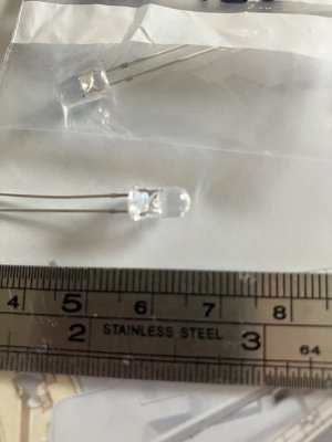

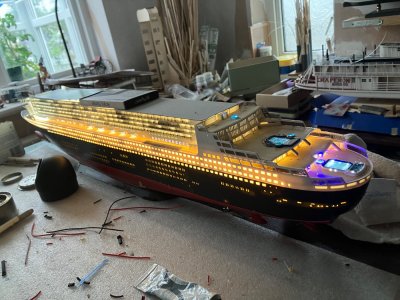

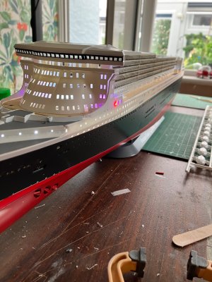

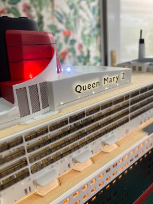

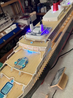

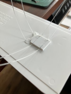

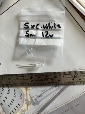

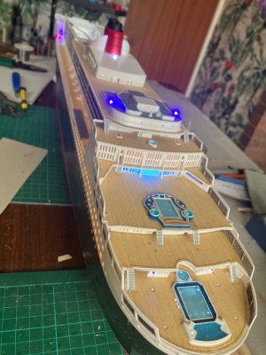

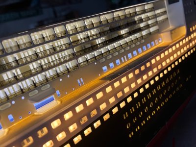

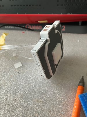

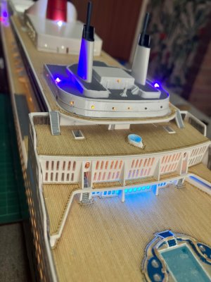

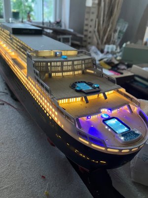

So, using 12v supply to everything, led tape lights for the main length of the hull and individual pre resistored 3mm led bulbs to light the .75mm and 1mm. Fibre optic cable held together in shrink wrap.

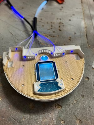

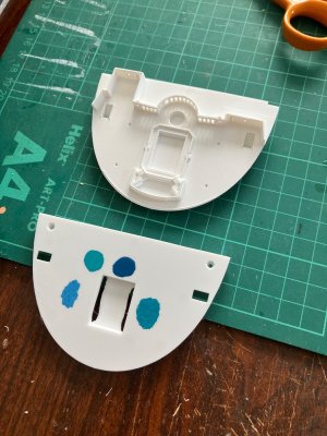

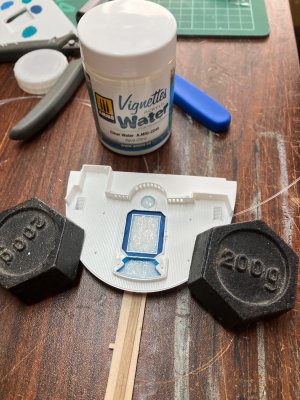

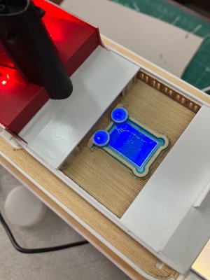

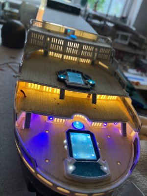

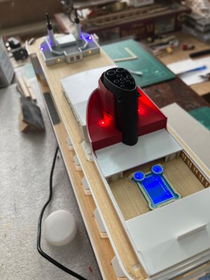

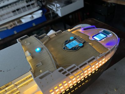

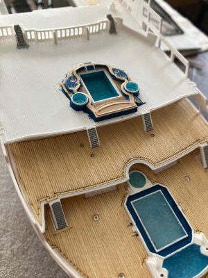

The swimming pools and spas having their first test. Nothing actually glued in the ship yet but just testing the individual sections first.

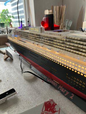

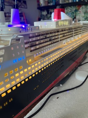

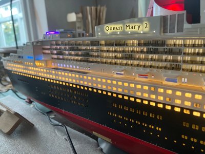

Wow! The last few pic's with the lights on are superb... it really looks like lights are on under the water. I'm very impressed.
