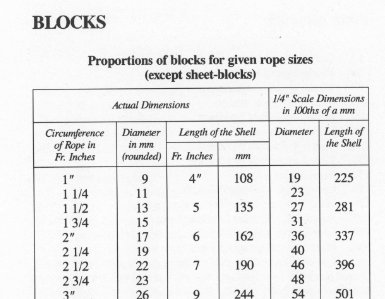

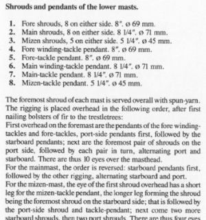

Generally speaking, the monograph will contain a list of rope sizes in circumference for each area of rigging. It will also give the sizes and types of blocks and tackle to be used to rig the line. Then there will be a drawing of the standing rigging and one of running rigging. This will tell you what lines go where but not specifically how to tie them off. I think there is an expectation that you either will have enough nautical knowledge to do the rigging from there or will have enough reference material at hand to help you complete any gaps in your knowledge.
Got it. Thanks. Could you show an example (screenshot) of how they describe the rigging application in the monograph?
