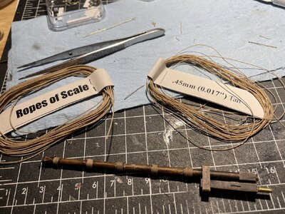

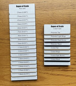

Hi Bob,
Sorry about the delay, I've been painting all weekend and had no time to respond to emails. I found yours in my spam box for some reason.
I might have some of those sample cards left if you are interested.
Cheers
Hi Ben, I would also like to get the samples cards. Pls, what is your contact ? Tks.
I'm out of the sample card at the moment but I'm currently making a new batch. You can contact me through the messenger function on this site or ropesofscale@fmail.com
