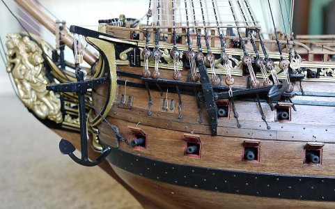

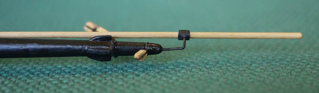

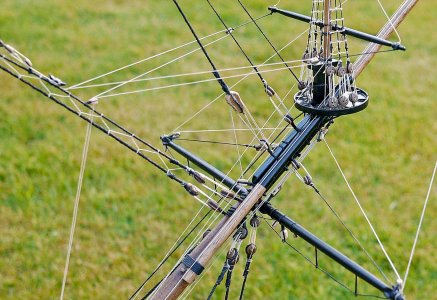

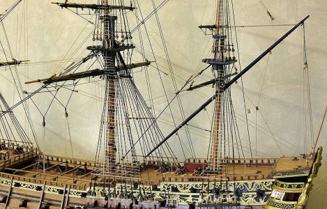

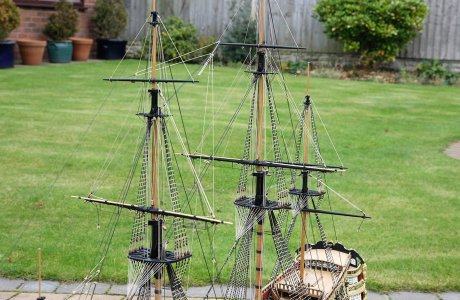

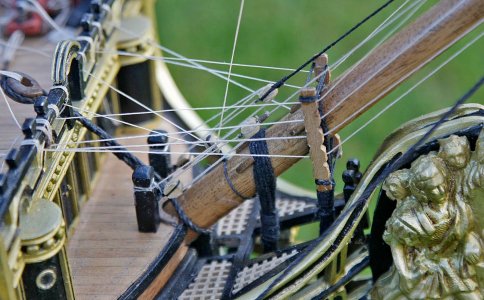

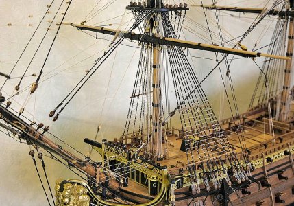

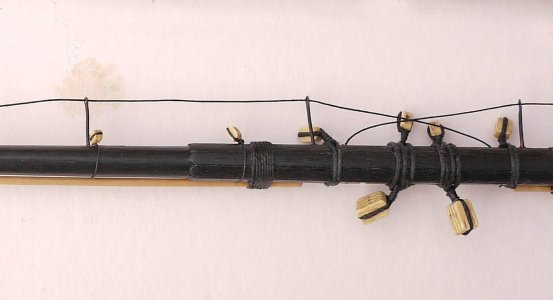

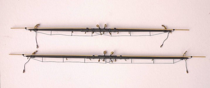

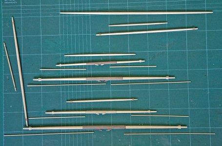

I spent many hours shaping and making up the yards with all their associated blocks and foot ropes.

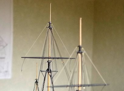

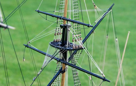

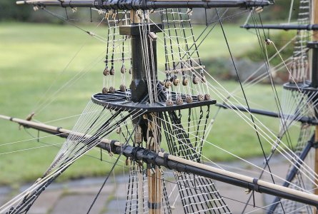

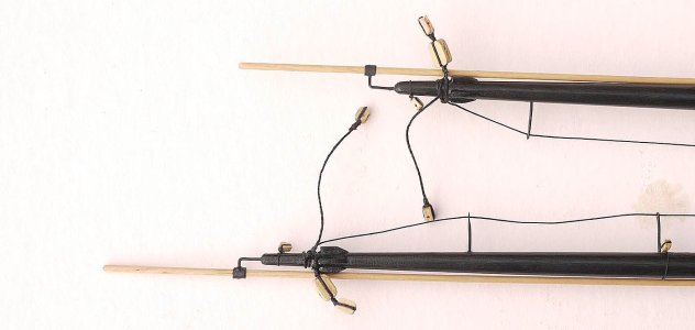

After some thought I came up with my own simple method of making the irons that support the yardarms. I bent a piece of brass wire to use for the yard end irons and used heat shrink tube for the hoops. I cut a small piece of tubing and heat shrunk it into place on the arm, it was quite thin so I put another one over the first, this gave a good thickness. I drilled a hole through it and passed a wire through, I drilled a hole in the end of the yard then slid the wire into it, I could move the wire in or out to get the correct size rod and I could move the yardarm up or down and rotate it until It was in the right position, a drop of cyno then fixed it in place. Lastly I trimmed the protruding wire and put a drop of matt paint over the end. Unless you knew how it had been made you would even after close examination think that it was a neatly made metal piece.
For the foot rope supports I used pieces of brass wire, I flattened one end, drilled a hole through, filed it round then blackened them. They were easily made and fitted. I think that they look uniform and neat and you need to be fairly close to know that they aren't rope, that did for me.

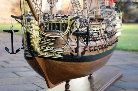

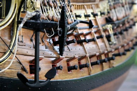

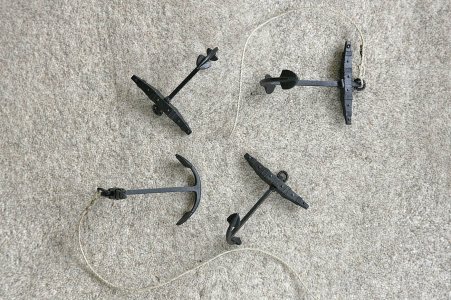

When I first made up the yard arms I tried using thin strips of black card as the irons but as they were only 2mm diameter I couldn't get it to wrap around and stick down it was then that I thought of heat shrink tubing and hey presto it worked. I thought that it would probably work as the metal bands on the anchors as well. Not all of my ideas work, most don't but you don't get to see those.
Again I think the photos show my workings better than my explanation.
