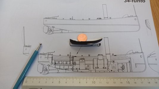

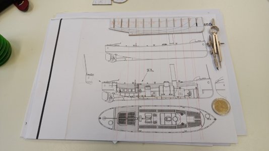

in my work on my Russian Battleship I "bumped into" the 34-foot Steam Launch and figured out a 1/200 and a 1/64 solution.
I do like this tiny model very much - but I do reach the very end of my eyesight.
Here some humble pictures for your kind orientation:

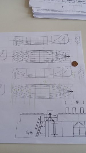

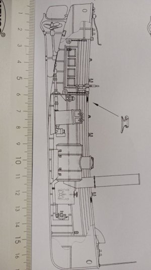

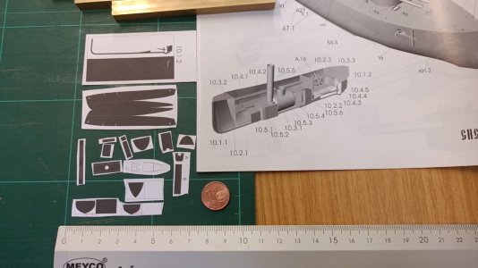

The 1/200 kit's drawing with some twenty pieces...
It really is a small model kit in it's own right.

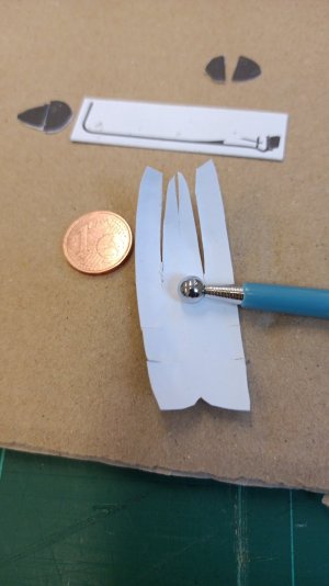

The hull is coming together like a little wonder by the use of my cheap embossing set. I do think about adding a thinest layer of cigarette paper glued inside.

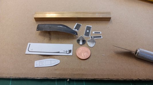

This is the amount of parts I do have to deal with.

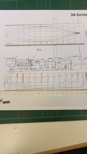

As I was absoloutly exhausted by this little time of working on the model kit, I decided to enlarge the plan from a Polish card model illustrate set onto 1/64 for trial purposes on the topic:

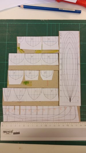

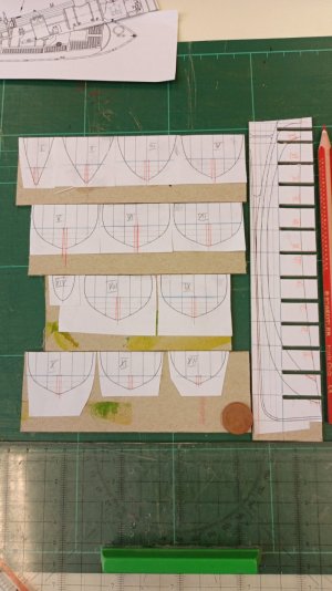

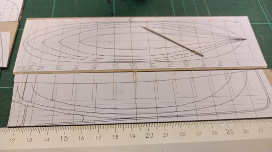

Here the cut CL-board's drawing...
...my first fight with these slots for formers/moulds/bulkheads...

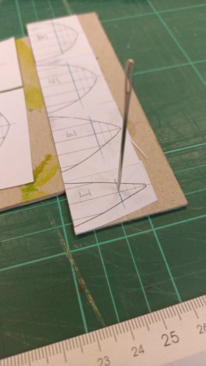

...scratching these lines into the 2mm-cardboard with a pointy needle...
So I was luckly able pointing the holes for the slot's grooves positions right into the cardboard and the glued drawing ontop.

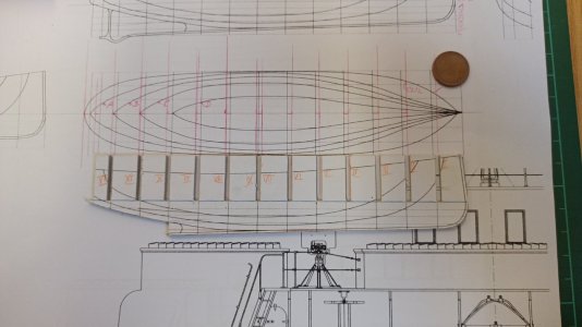

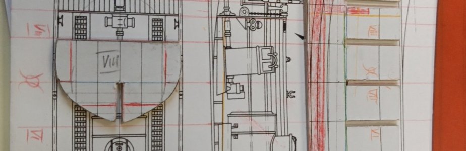

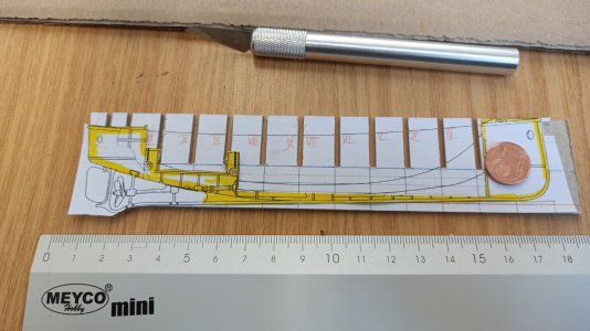

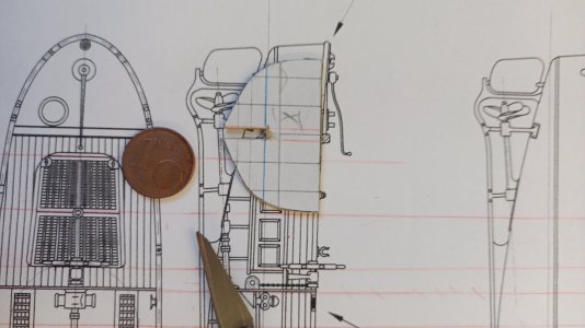

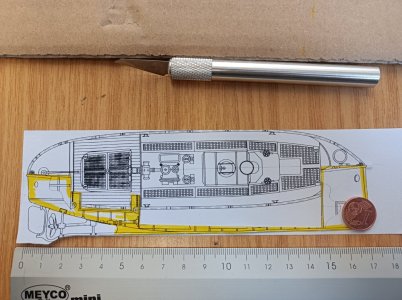

Here today's hole progress in cutting the bulkheads slots into the CL-board and dealing with the real shape of the boat - shown here in yellow. Mould N° II is displaced right infront of the f'c'stl real bulkhead - what can I say?
I do think you do see the trouble I did run into!
Speechless

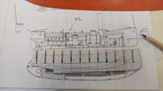

Compared to the top-view it looks like a reasonable solution for the model:
So I may be able to get some structural thinks done by using the bulkheads as formers:
We will see tomorrow what is possible to do - hopefully.

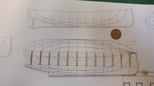

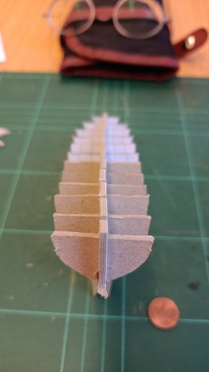

Yesterday there was a bit of good progress:
By cutting the bulkheads' slots in the CL-board; and marking the 2mm contra-slots into the bulkheads (red lines) I was able to get some nice results:

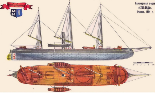

A twin-masted boat of the Monitor RUSALKA class in 1:35 (reduced downwards to 1/64) scale. By this I will come later on towards the nice nickel plated small
Russian gunboat STERLYAD of 1855 and
the ill-fated Russian Coast defence monitor RUSALKA...
As both builds are from medium detailled plan sets of the Russian Admirality - so it is necessary these builds were supported by a 1/100 cardboard kits STERLIAD out of W.M.C. publishing detailling

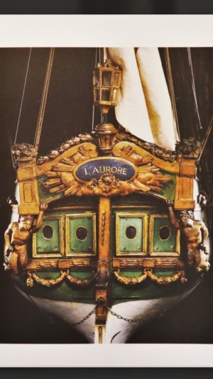

Pleasure Ship L'AURORE by G.Delacroix/Ancre Monography-Nice

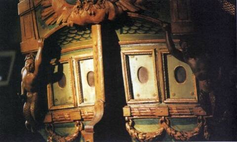

...to get closer to carvings and the much more complex wooden architecture
of the transom and the figurale detailling in a lesser number on the storyboard of the stern's detailling.
Why this pile of smaller and easier models? By this workaround I do plan reentering my splended
recently moored AKERBOOM 1664 project (here the much more detailled GUDEON transom by v.d.Velde) to be fit for the challanges and problems of the build of a baroque ship - hopefully...

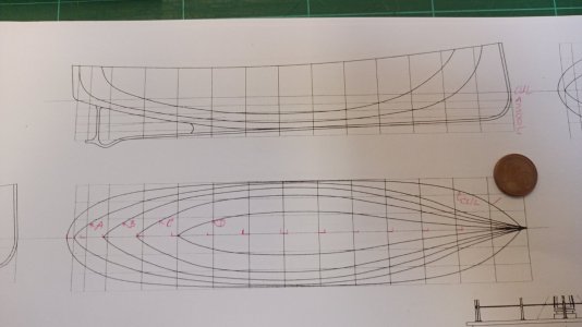

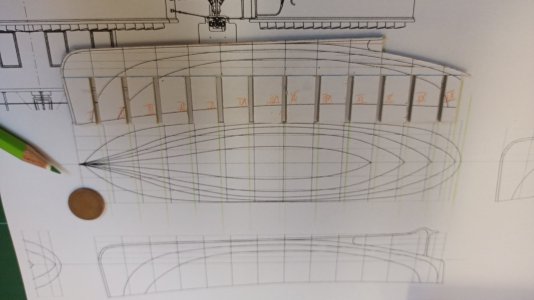

Today's first steps to the hull's finished under water curviature we're done:
The first attempt wasn't precisely enough drawn:
But a good foundation to show the finished parts to fill the under water lines with cardboard:
So the 2nd trial was better (beside the main former not being placed exactly enough) in result:

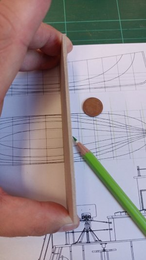

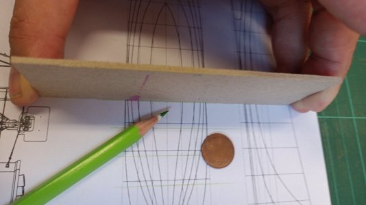

The next trial was done by using the 2mm-cardboard instread of a measurement by a ruler:
and certraily a pointy pencils:
So this is the result even in the photocopy:

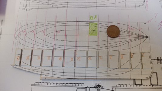

Here is what I try to get out of this shown as a "Green Area" - the horizontal (WLine A) underwater hull slides between CL-board and WLs (being a segment of bulkh'd VI) to add a bit of stability into the construction:
Doing this I will have to lift the engine's and boiler's floor a bit - simplifying the hull's construction by feaking deep into the hull by weathering. Never tried something like this... :cool:

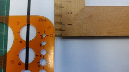

My first attemnpt to draw exactly 2mm - the thickness of the cardboard - not too great results at first:
I tried and got here the result:
A two millimeters circle as I wanted to get it.

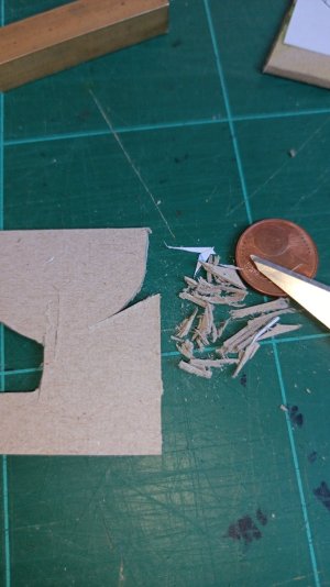

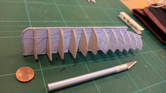

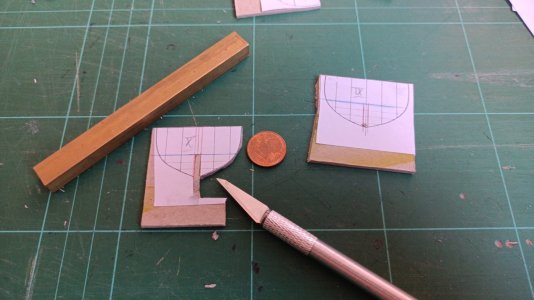

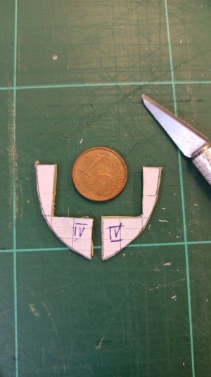

Today is HappyMouldsDay!

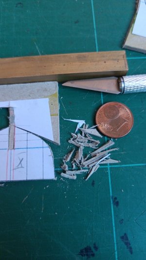

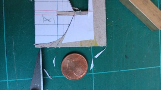

Here how to cut out the moulds without sanding:
First cutting the easiest tangente (without any risk to touch the inner body:
Then I started cutting out pointed wedges (a lot of) to a pile:
P.T.O. :-)

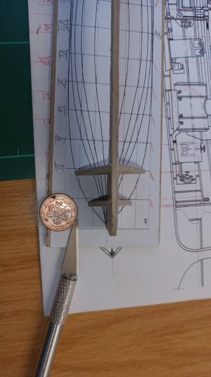

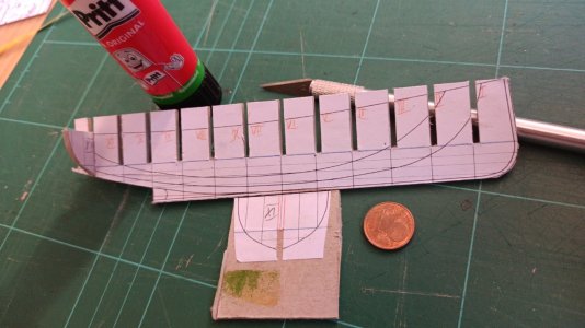

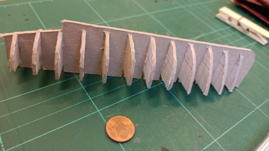

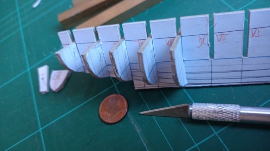

The CWLs of the CLboard and the moulds do come closer to eachother:

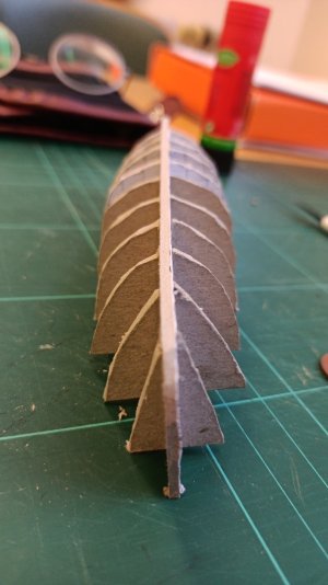

Here the all the aft moulds (mainly) in position:

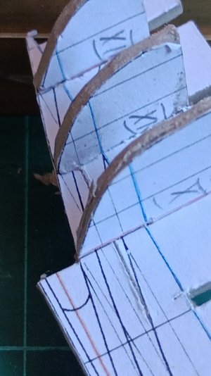

To bevel the moulds I will just soak them with cyan glue to get a material I can Work with - without spreading layers and layers and layers...

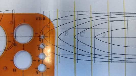

Here today's progress not a lot but highly important:

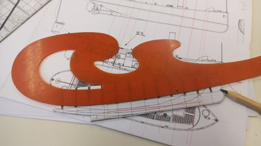

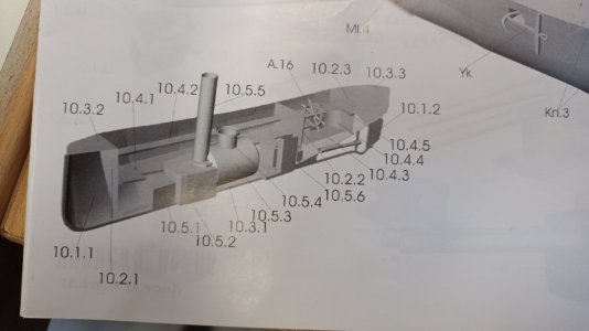

I figured out where to place the different lines for the engine's and boiler's floor and the well's floor by pointing the ends:1000030249.jpg
Then using the ''curve ruler'' to find the line of the bent floor of the seats' Line:1000030250.jpg

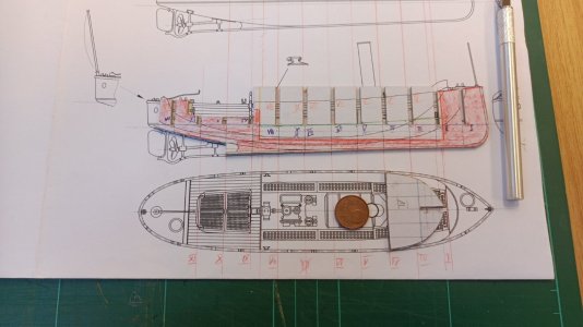

Here we are with floor's line in red as the minimum of "keel" that is left:
And the red surface is now the space that is to be left:
I hopefully can avoid the slim part below the slot of bulkhead II - a dangerous leck of material to work with!
But how to fix problems of stability in the "rump of bulkheads" that is left - after the cutting away of what has to dissapeare?

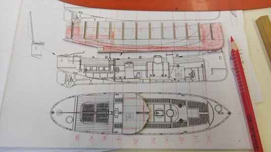

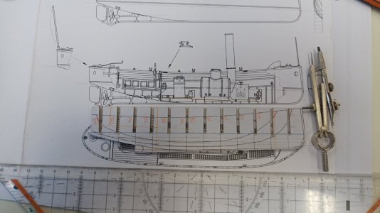

This is today's work's output:

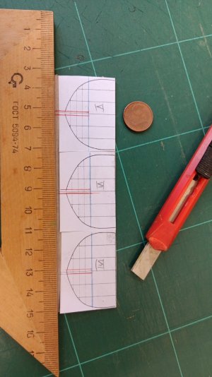

Cutting the CenterLine-Board for the helmman's well and the engine and boiler. Some parts will be sliced into two:
Every bulkbead has to be constructed seperadly out of top- and siedeview:
so the measurement are found in both layers:
The bulkheads do start to fit to the WLplan but I am not very happy about the slim bulkwalk I do have to build admidships - or more precise without the very first stem and sternbulkheads.
So let's see what is going to be tomorrow...
