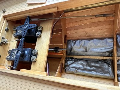

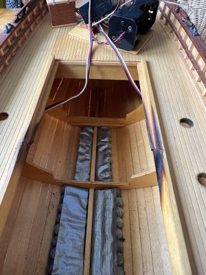

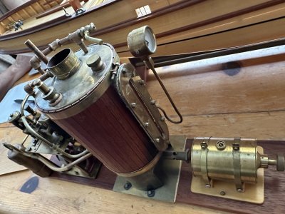

Here's a photo of my steam plant. I mounted all of it on a 1/4" piece of mahogany so the whole thing can be lifted out. The below deck area forward of the deck house is where I keep the batteries and RC receiver. In case you're wondering, the ballast along the keel is .36 cal. lead balls duct taped into removable bunks.
BTW, the charred wood in the second photo happened when I accidentally set the burner too high and couldn't see it well because of bright sun. Luckily I was running it with the deck house off. I had to jump in the pool to splash the fire out. You can also see a little but of charring of the lagging on the bottom of the boiler. That was a scary day.
Beautiful craftsmanship. Glad it didn’t end up in flames! Another question for you: Thinking about control of the engine and boiler with R/C…. The Saito system has a throttle on the boiler that controls steam to the engine, and the engine has a lever that controls direction and RPM. I see you have 2 servos… Rudder and throttle? Does the throttle control steam to the engine, or the engine, itself?
On the Krick engine a single lever controls both engine rpm and direction, so that's one servo. (There is no separate valve at the boiler to control steam flow.) The other servo controls the rudder.
