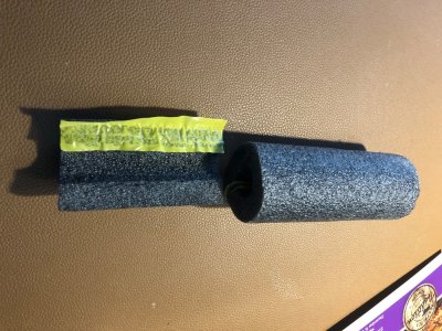

Hello again, Jim, and thank you for the informative explanation about abrasives. It clears up a few questions I had regarding the different types of paper and their uses. Based on your advice and the suggestions from a few others in the thread, I have put together a small collection of the different types of abrasives that everyone has recommended. I am still trying to figure out the best sand block approach, as many people have given different advice on how to use abrasives and which blocks are most useful. Thanks again for the video, and keep the advice coming, it's very helpful.
