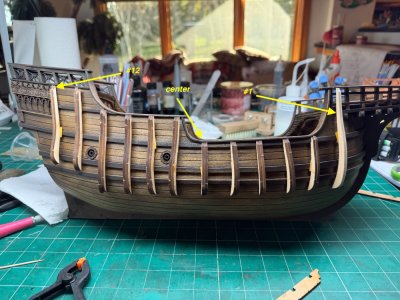

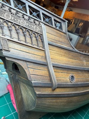

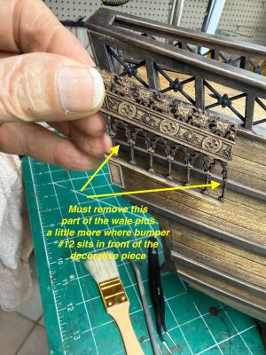

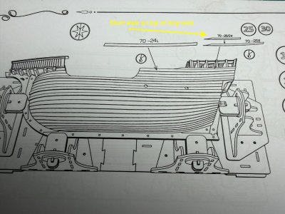

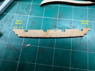

Hi Rob, the graphic on the bottom of the image above (Pack 8) shows the bumpers are already notched??? I doubt the manufacturer would do that since wale locations could vary between builders...but it might give you a clue on how to proceed?

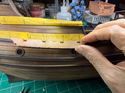

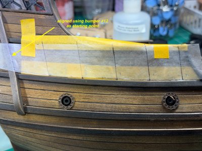

For sure you need to do this.Guess the logical thing to do is put tape on the hull and "mark" where the bumpers should go.

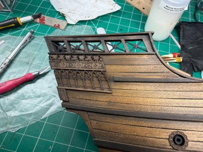

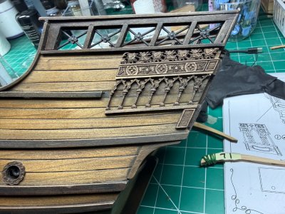

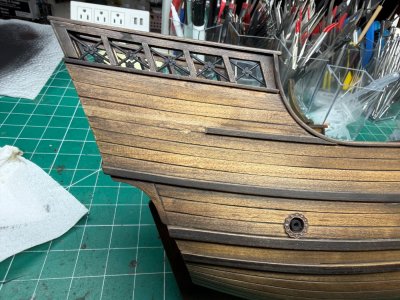

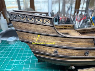

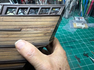

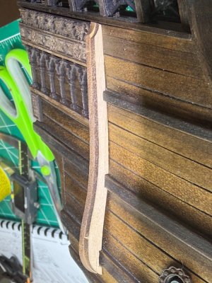

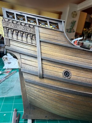

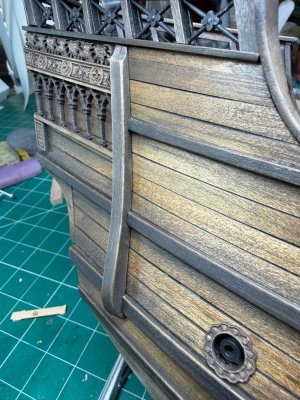

i was able to clean up the hull a little from removing the wale. But there was quite a bit of CA glue and the dry would not stick to it. i scrapped as much CA off as I could. There were still light (and shiny) areas the dye would not stick to. I ended up applying some similar colored paint with a tiny brush, then airbrushed over again. The dye stuck to the paint. It's a little darker than the surrounding wood, but the wale I removed is walnut and the 1st wale below it is also walnut.
