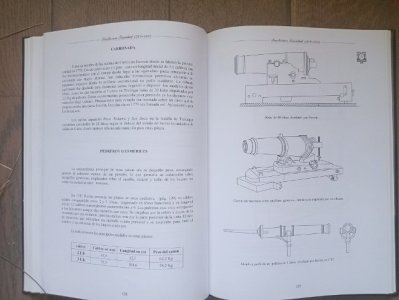

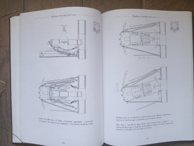

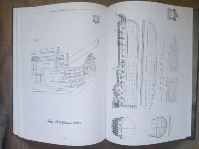

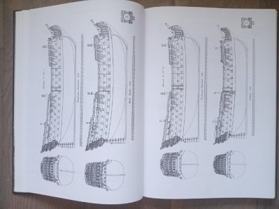

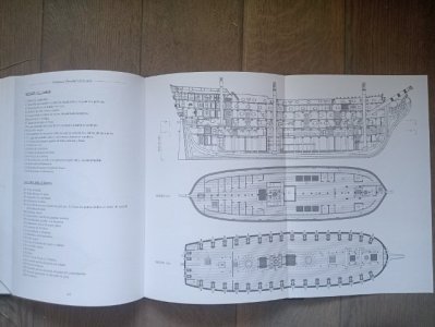

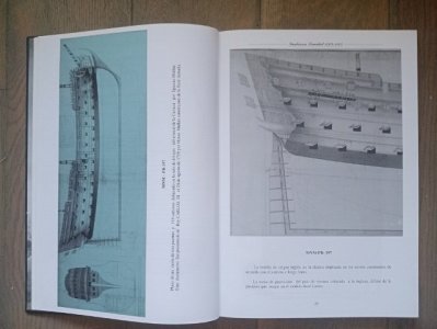

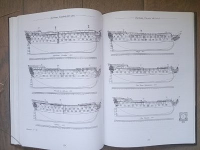

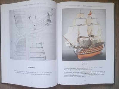

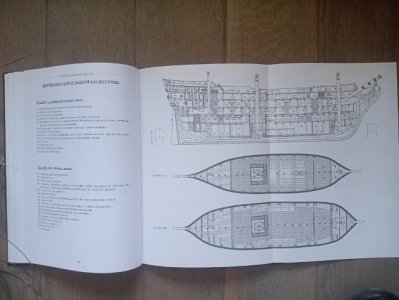

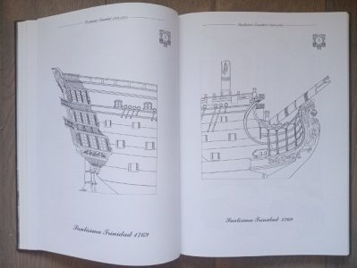

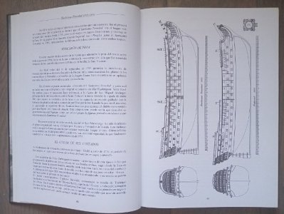

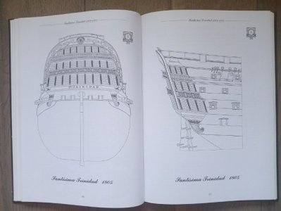

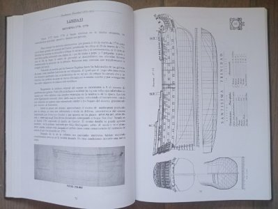

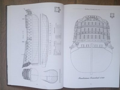

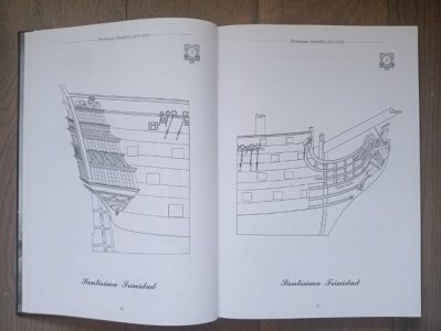

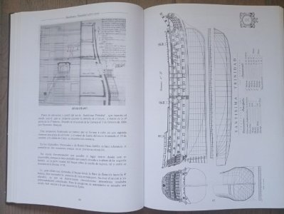

Out of the many excellent modern Spanish works, it is enough to just aim for one monograph by Joaquín Rodríguez Crespo – Navío Santísima Trinidad 1769–1805. Reconstruccíon gráfica y documental, Ediciones del Hobby, Madrid 2007, 978-84-612-1517-1 (including CD-ROM). That's the book on the right of the first photo.
As an aside, I have no idea why Spanish users don't point to such things.

I think that Joaquín Rodríguez's monograph is the best study about this ship. I would like to have it but it is no longer available. I would say that Liberto's work, which can be seen in this forum, is based on plans that appear in that book.
Cheers;)
