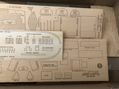

I found an offer on ebay with some photos of drawings
can this maybe help to find out which scale?

Ditto Mike. As a marine engineer myself, the terms used for measuring a ship can be quite confusing. If you take the LOA figure and compare it to the kit parts such as the deck sections, you can get a more much more accurate ratio for determining the scale than using the boat as a measure. I would not trust the kit's boat to be accurate in size, and you would be introducing a huge error into your scale calculation even if you did, because of the small size of the boat as compared to that of the ship.
