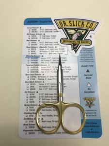

Being a novice at this type of ship building I bought these. I’m quite happy with them. Even after rigging my Enterprise they still remain quite sharp.

Thanks Jan! Until I blew up the picture and saw that Dr. Slick Co. sold fishing gear I was wondering if they supplied surgical instruments!! How'd you like to see that on the tray as they roll you into the operating theater!!:D

Jan, I just ordered some of these. Should arrive this coming week. I saw your post in another thread and found some on eBay!

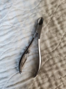

I use these to cut the rigging lines. They work great. They cut the thread clean. They are really sharp and hold up well. They are clippers for toe nails. I got them at the drug store for 8 bucks. They have a curve and it is easy to get in tight places.
