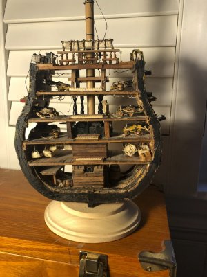

If your model is sufficiently small, perhaps just some thick wire would do as I did with this small 18th century long boat. I used vinyl covered wire.
Thanks for this suggestion. This apparently works just fine for this model. I think that my VICTORY cross section would be too hard to balance once I get the main mast, all the yards and what rigging is needed installed. This will be a tall model, almost 36". Someone suggested looking at an Ace Hardware for loose screws. This was the ticket as I was able to get two 1" long, #4 wood screws which I then used to secure the model to the kit's round base after countersinking them in shallow holes drilled using a 1/4" d. Forstner bit. This solved the problem for now anyway. Because I am not to thrilled with the round one, I might change the base later to a rectangular one that I can mill to accept a glass or plexiglass cover. attached base.jpg
