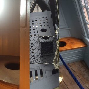

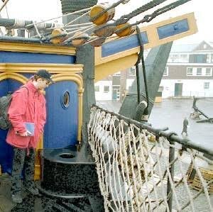

HMS Victory’s heads. From the left internal in the roundhouse on the f’cstle, on the beak head of the f’cstle itself and the last in the quarter galleries C3E7F244-A48F-4534-836B-BD318F30878C.jpeg

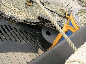

Another set on the beakhead, up against the forward bulkhead. This was the same on smaller frigates and possibly sloops like the rattlesnake. 139025B8-7889-4B98-AB5D-FE9135097D2B.jpeg

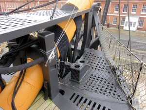

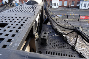

And often mis looked on models are the piss pots. A urinal here on the f’cstle though also would be found towards the aft end of the waist near the beginning of the main mast channels.50B57257-2696-439C-B283-6ACDEEF697BD.jpeg

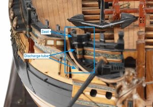

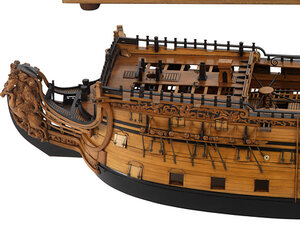

They come in various types, here are a couple of pics, in this pic they are just behind the figure head
a little box seat for two,

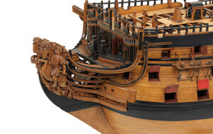

here is another view of the same ship you can just see the two white rings
below the gratings,

Extremely helpful. I now have my design in my noggin.
