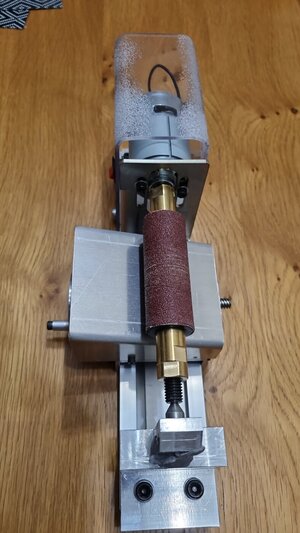

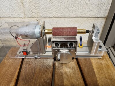

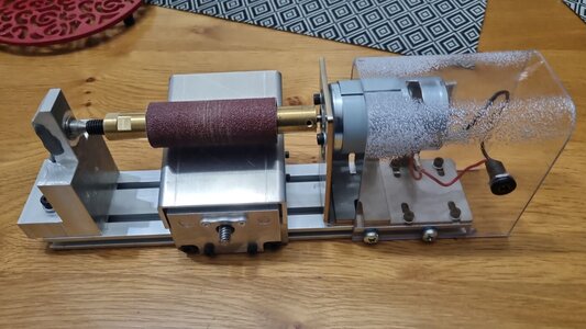

In fact, I took a lathe that I bought about two years ago and which did not meet my expectations and based on it we built the sanding machine. We left the motor, added a standard sanding drum that is sold on many websites.
we made the inclined/angled base, on which the wooden board rests and which moves on a pivot base back and forth. The dimensions of the machine are 46 cm long, 8 cm wide and 16 cm mandatory.

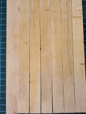

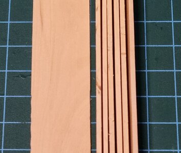

Today I did my first significant job with the sander past the Alert model, and I am satisfied with the results.
I will attach photos and a video for you.
IMG-20221113-WA0009.jpegIMG-20221113-WA0011.jpegIMG-20221113-WA0013.jpeg20221113_204026.jpg20221113_204029.jpg20221113_204051.jpg

Question, looks like the drum turns with the wood.
It should turn against the wood for a smoother result. That means, when you put the wood in the drum it wants to push the wood back and the dust goes up in the air.
thanks my dear friend :)
You are right, dear friend, I did this because I was holding the smartphone in one hand and the Wooden board in the other, which is the most uncomfortable. :D:cool:
But basically it should be done in the opposite direction

Shota, a couple of questions 1) what is the least thickness you can manage? and 2) how consistent is the tickness?
the least thickness that I have experienced so far has reached a thickness of 0.5 millimeters for the entire length and width of the board. Maintaining the thickness is possible because of the design of the rod on which the sander moves, including the support at the other end in front of the engine. We made sure to have a stable and level rod despite the varying rotation speeds. I make sure that the associated board moves in a straight line and uniformly.

In light of the members' questions and comments, I would like to add a few details that will help you.
In fact, we dismantled the lathe and redesigned the structure: first the back to the engine support in order to allow the surface on which the wood moves to move in different thicknesses. On the other side, we built a support for the rod on which the sanding roller rotates, thus ensuring that the same thickness is maintained. Our name is Masev behind the support ooze. The surface on which the wood moves moves on the basis of a screw that connects all parts of the work surface and the anchor to the base of the machine. Good night, hope the details help
