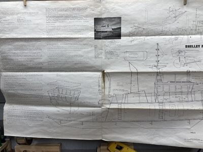

My initial build log on my Dumas “Shelly Foss”, .4” to the 1ft scale, I believe 1/30th scale. Finished dimensions, length 36”, beam 12”, draft 7”. I haven’t decided to go static or make it operational. I will proceed as if it will get wet.

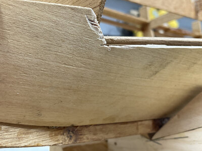

1. Trimming the keelson strake to meet double longitudinal.
a. I used my Dremel Multi Tool (vibrating cutter) to cut excess from keelson strake, I’m learning
as I go and am getting nice results.

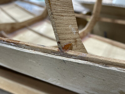

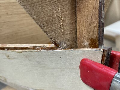

2. Re-gluing busted joints from years of moving around.
a. Epoxied and fixed issues.

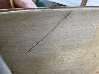

4. Keelson strake has two real prominent bulges from improper gluing and clamping.
a. I cut reliefs in plating to allow the strake to lay flat in relation to the support structure. Great results.
