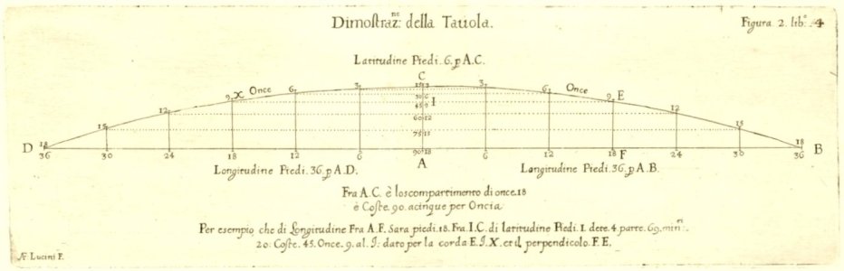

Genoese palms, three of which make two feet, and six English inches, which make one cubit,
I started reading a bit more of this treatise. I am not sure how practical it will be but it is a really interesting read for anyone interested in naval architecture especially for the era involved. One example.....
